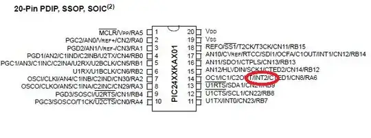

INT2 is selectable port for the PIC I use. Pins
