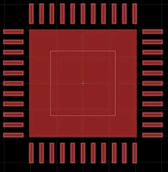

In EAGLE, the layer that dictates the stencil pattern is the "cream" layers (as far as I understand).
One of the cream layers for my QFN looks like this:
The IC is 7mm x 7mm for perspective.
But I'm told that for the slug in the middle. It shouldn't be a giant square for the stencil, because it will be too much solder paste and when you reflow, it will short all the pins. Therefore, one must alternatively use smaller "holes" (example in blue) on the slug to limit the amount of solder paste is placed on the pad.
I personally never would've predicted this caveat so I'm glad I was notified of this potential issue.
Should I also restrict the solder on the pins as well? I don't want to risk shorting those.
Question
Is this right to place the holes? What other potential caveats or pitfalls one might face when attempting to develop a proper stencil?

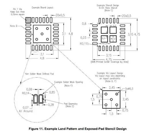

From page 12 of this: http://www.ti.com/lit/an/slua271a/slua271a.pdf
It looks like their suggestion is square apertures in the stencil and you should aim for 50-70% of the center pads area to have solder paste after stenciling. Page 12 of the TI Application Paper, per suggestion

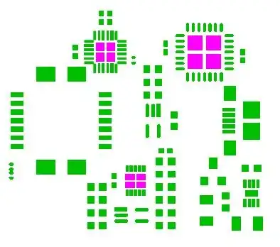

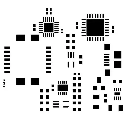

I must admit that I'm often to lazy to do this myself, because I know that I can rely on my PCB vendor to sort it out for me. YMMV ...
As an example below: This is how my solder paste layer looks in my PCB design package
and this is the check plot they sent back to me with suggestions for "20% window size reduction" applied to my QFN & DFN parts (the purple coloured blocks).
To get an idea of scale, the 28-pin QFN at the top-right is a 6x6mm PIC32MX270F256B.
If I did the measurements carefully I'm pretty certain that I'd find that the sum of the areas of the purple blocks is 20% less than the area they're replacing.
