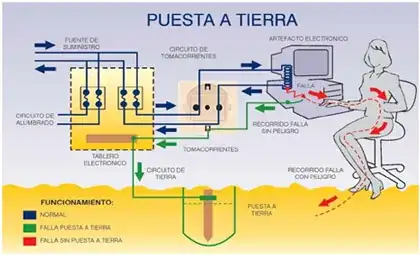

I'm sorry this is in Spanish but I think you will understand.
Basically the red path is what current does when the device is not grounded because the current flows across you in order to return to its neutral point (grounded)
The green path is what current does when the device is grounded, it does not go through you because the "easiest" path is its ground connection.
The current flows because you are holding a wire with a potential of 220VAC to somewhere else (this place is the earth). If what you touch is the neutral wire it should be okay if the instalation is properly done, because its potential to earth sould be 0 (or very close)

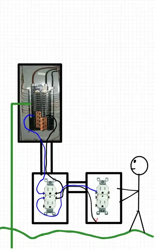

    I think what he is asking is how the blue circuit "knows" that the incoming [live] is at high potential and the outgoing [neutral] is at ground potential, rather than the other way around or somewhere between, when [he believes, and your diagram shows] there is no connection between either one and the ground. By analogy, it's perfectly safe to touch the positive terminal of a battery when there is no connection between the negative terminal and the ground. – Random832 Feb 03 '15 at 17:31
  • Well at least here, it is because the neutral is conected to ground, so if you touch the high potential wire you are closing the circuit because you are connected to ground. I mean, maybe it's not well explained and I am assuming he knows that the neutral wire is conected to ground. – zapeitor Feb 03 '15 at 17:54
  • A lot of diagrams do not show whether the ground is connected to the circuit neutral, so is that a taken for granted? – Jake Feb 07 '15 at 06:50
  • It depends on the earthing system, and it depends on the country I believe. You can check it here: http://en.wikipedia.org/wiki/Earthing_system#Low-voltage_systems I am talking about the TT Network. – zapeitor Feb 07 '15 at 09:00
