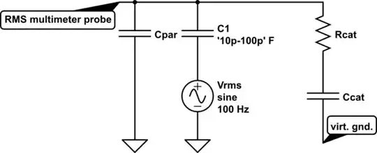

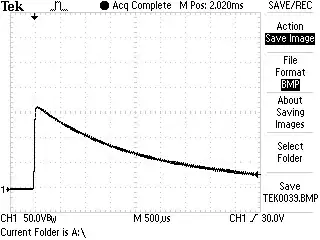

28
As a bit of a riff on Spehro's, Capacitance ~ radius. You can measure your own body capacitance with your 'scope. Hook up the x10 probe, set you triggering for single shot, Scuff your feet or rub your sweater (jumper in the UK) and touch the end of the probe. You'll see your discharge through the 10 Meg Ohm of the 'scope probe. Find the 1/e point. Here's a 'scope shot for me. (You have to play around a bit to get the right amount of scuffing.) I get about 2.5 ms ~ 250 pF. You could try the same thing with the cat.
/ enter image description here
Oh for the cat (or more accurate numbers) you should subtract the probe capacitance.
(about 16pF for my x10 probe.)
Edit for comments: This is an example of an RC decay. RC is the time constant of the circuit. See the wiki article here. A quick estimate of the time constant is the take the time when the voltage has dropped to 1/e of it's starting value. (1/e is about 1/3) In the 'scope shot above this time is about 2.5 ms = RC (R = 10 Meg ohm)
George Herold
  • 4,754
    This looks like a reasonable method. However, I don't have a scope at home. I'll have to ask at the hackerspace if cats are allowed... – timthelion Feb 02 '15 at 15:36
    I always get a positive going pulse. I tried rubbing with other materials.. but nothing going negative. Your results may differ. (just a warning) – George Herold Feb 02 '15 at 15:48
    @Kynit, Thanks, my first answer at ten, I got a badge or something... figures it would involve a cat. It was J. Larkin on sci.electronics.design who taught me this trick. (I was seeing some sort of weird effect from touching my circuit.) I remember because he was disappointed that I had a longer decay time... it meant I was bigger. 5'11" 165 lbs. What's your decay time? – George Herold Feb 05 '15 at 00:40

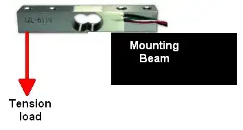

Problem Meowtivation and Purrpose
How does one measure weight in space? Certainly not with a scale, because there's no gravity. One must use a special apparatus to deduce it indirectly - through oscillation.
Similarly, you are trying to measure a value of a cat, whereby you cannot directly measure the capacitance. Luckily, there are a few things we know from physics that occur in capacitors that we can use to deduce our feline Faradicity.

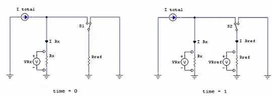

The best way to skin this Catpacitor
While a few of the other methods posted here seem workable this test can be done with out the need for an oscilloscope or several specific values of high voltage capacitors. Though a high impedance/high voltage meter is a necessity.
A better way to handle this would be to treat it similar to a simple current divider circuit then derive the basic equation to calculate Ccat directly.
As in this first circuit determining Rx is not so difficult if the other values are known. At time = 0 the current flows only through Rx. At time = 1 the switch changes and the current divides between the two paths (through Rx and Rref). The amount of current in each path is determined by the resistor values. The main idea is that the total input current remains the same at both switch positions, but the voltage on each resistor will change due to the different currents in each branch. Using Ohms law Rx can be calculated by measuring the voltage changes and knowing the value of Rref.

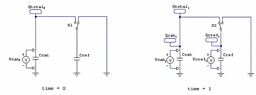

In this next circuit pair we introduce the Cat with an unknown capacitance (Ccat) to ground. At time = 0 there is fixed total charge in the circuit (Qtotal0). This is the initial charge on the Cat (Qcat0). The initial charge on the Cat produces an initial voltage (Vcat0).
At time = 1 the switch changes and the total charge divides between the Cat and a reference capacitor (Cref). The voltage on the Cat changes (Vcat1), due to the charge transfer. The charge transferred to the reference capacitor produces a voltage (Vcref1) which is equal to the voltage on the Cat (so Vcat1 = Vcref1).
It is important to note that even though some charge has been transferred the total charge now in the circuit (Qtotal1) is still equal to the initial charge, (so Qtotal0 = Qtotal1).
In similar fashion to Ohms law the voltage on a capacitor can be found with the equation V=Q/C. Manipulating this equation the capacitor’s charge can be found by Q=VC. With the capacitor charge equation and knowing the value of Cref it only requires two high voltage measurements (at time = 0 and time = 1) to determine the capacitance of the Cat, as shown below.
Terms used:
Capacitor Charge Equation: Q = VC, with Q in Columbs, V in Volts, C in Farads
Qtotal0 = Total initial Charge at time = 0
Qcat0 = Charge on Cat at time = 0
Qtotal1 = Total Charge at time = 1
Qcat1 = Charge on Cat at time = 1
Qcref1= Charge on Cref at time = 1
Vcat0 = Voltage on Cat at time = 0
Vcat1 = Voltage on Cat at time = 1
Vcref1 = Voltage on Cref at time = 1
Ccat = Capacitance of Cat
Cref = Reference capacitor
Calculation:
@ time = 0, measure voltage on Cat (Vcat0).
Per capacitor charge equation (Q=VC)
Qtotal0 = Vcat0 Ccat
@ time = 1, change switch, measure voltage on Cat (Vcat1), this is also the voltage on Cref (Vcref1).
Knowing that the total charge in the circuit has not changed:
Qtotal0 = Qtotal1
Qtotal1 is made up of the charge on the Cat and the charge on Cref, so:
Qtotal0 = (Qcat1 + Qcref1)
Rewrite these charges as their equivalent form per Q=VC:
(Vcat0 Ccat) = (Vcat1 Ccat) + (Vcref1 Cref)
Recall that with this switch position Vcat1 = Vcref1, substitute into the equation:
(Vcat0 Ccat) = (Vcat1 Ccat) + (Vcat1 Cref)
Bring Ccat terms to one side:
(Vcat0 Ccat) - (Vcat1 Ccat) = (Vcat1 Cref)
Factor out Ccat:
Ccat (Vcat0 - Vcat1 ) = (Vcat1 Cref)
Isolate Ccat:
Ccat = (Vcat1 Cref) / (Vcat0 - Vcat1 )
Done...
Now for an example:
Use a standard value of 100pf for Cref, measure Vcat at time = 0 and at time = 1, (use 9kV and 4kV)
Ccat = (4kV 100pf) / (9kV - 4kV)
Ccat = 400pf / 5
Ccat = 80pf
Using a single relatively low value (high voltage) capacitor your Cat capacitance can be calculated, with less chance of any cat-tastrophic consequences.

If the small signal model of the cat looks like this:
Then you can measure the catpacitance Ccat with a low frequency sine oscillator and an rms or peak voltmeter like in this setup (note ESR above is Rcat below):
simulate this circuit
Method:
  • First connect the rms multimeter directly to the sine oscillator to assure you have a 1 Vrms sine, and that you get a steady reading.
  • Keep the cat disconnected and apply a sine through C1 with only the probe connected. Then find the probe parasitic Cpar by calculating: \$C_{par} = C_1(V_i/V_o - 1)\$ , where \$V_i\$ is the 1 Vrms input signal and \$V_o\$ is the measured Vrms output voltage.
  • Now connect the cat and apply a sine with the probe connected. Then find Ccat by calculating: \$C_{cat} = C_1V_i/V_o-C_1-C_{par}\$ , where \$V_i\$ is the 1 Vrms input signal and \$V_o\$ is the measured Vrms output voltage.
Getting a good connection to the cat is probably tricky. Something along the lines of an ESD wrist-band, laced with some safe conducting gel or similar, might be necessary. The nose might be a suitable place to get a good connection, but be nice ...
For good sensitivity, the best choice for the value of C1 is when C1 is close to Cpar+Ccat.
The equivalent series resistance shouldn't cause problems but to be sure, repeat the measurement with a frequency one octave down until you get the same result. If you get varying results, but they are repeatable at the same frequency, try to make a bode-plot of the magnitude response, and then ask again with some measurement data. Finally Ccat and Rcat is wetware, so they are probably not too stable over time.
Your cat is also an antenna, therefore she likely picks up 50/60Hz from the mains. This source can maybe be discounted if measuring a small rms output value when connecting the cat while keeping the oscillator output grounded. (If the antenna signal is large you may be able to find Ccat by another method => only varying C1.) In the method above, if the antenna signal is large you should try to pick a frequency for your measurement so the signals won't depend too much on the phase relationship.
To get measurements over time, with a detailed time-resolution it's necessary to measure/record the output voltage with a scope. The same equations apply when measuring peak amplitude as for rms. Therefore, amplifying the output and then using a halfwave rectifier should provide an easy circuit to allow a continuous reading of the catpacitance.
Finally, if you want to measure the the capacitance as a function of the voltage during the discharge, then you should record the discharge with an oscilloscope as also shown by George Herold in his answer. For this setup use a square wave oscillator, and add a largish discharge resistor. Then calculate the capacitance based on the rate of change for the voltage, and the known current (known from the voltage and the discharge resistance).
$$ C_{cat} = \frac{V(t)/R_{discharge}}{\frac{d}{dt}V(t)} - C_1 - C_{par} $$
