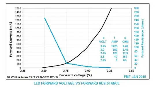

In the case of the CREE XP-G you referred to, I've taken the Forward Voltage VS Forward current plot from the data sheet and overlaid it with the derived Forward voltage VS Forward Resistance plot as shown below. Rather crude because I didn't do any curve fitting, but it's easy to see the huge change in forward resistance for the smallish 250 millivolt change in forward voltage from 2.5 to 2.75 volts.
Because of this extreme sensitivity to voltage and because the location of a diode's knee can't be predicted with great certainty, LEDs aren't generally driven by raw voltage sources, but by constant current or current limited voltage sources designed to never allow the product of the current through the LED and the voltage dropped by the LED to exceed the power rating of the LED.
