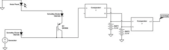

The circuit I've come up with so far looks like this:
It is more of a general idea than a real circuit schematic.
The solar panel and generator are switched using a PNP transistor. When the generator is outputting a voltage at the base of the PNP, the current from the solar panel stops flowing. When the generator is not outputting a voltage, the current from the solar panel is let through the PNP from emitter to collector.
Now the next part does not make sense schematically. The comparator is meant to compare the voltage of the two batteries. The one that has less voltage should be charged by either the generator or solar panel. This is called the back up battery.
The next comparator again (redundantly?) compares the voltage of the same two batteries. The one that has greater voltage will become the primary battery, which supplies power to the rest of the system.
Does this idea seem reasonable? How can I efficiently switch between the batteries based on their relative voltage? (Low power consumption is a huge consideration here.)
Thank you for taking the time to read over my ideas. I would really appreciate any help with this!

  • You are still in the system definition stage and it is hard to give definitive answers since they would depend on the system requirements and details of the components. But in general, my approach would probably be using a uC as the controller. It would have a number of ADC channels for monitoring the voltage levels. The actual switching would be simple MOSFET circuits. – rioraxe Jan 30 '15 at 22:11
  • The system needs 10.86 Wh, but 10 Wh are due to having a fingerprint reader that is continuously on. If we can switch that component off and on then we need less than 1Wh of power. We are using a PIC24 microcontroller with 10-bit ADC so your suggestion for battery monitoring is a good idea. However, my question then is do I need to switch between batteries in this manner or can I just switch charging on and off for one battery? – Christina Jan 31 '15 at 03:23
  • If you are using 9V batteries, then connecting them both to the system with schottky diodes of say 0.5V drop does not result in a lot of loss. So that could be one way and is simple. And if one battery is rechargeable and the other is not, that is a possible configuration. But ultimately, it really depends on your requirements. – rioraxe Jan 31 '15 at 22:26
  • A 9V battery would unfortunately not be an option because it is a small system and thus has a size constraint. I was looking at AAA batteries, but they just need to be smaller than about 100 mm x 80 mm (they must fit inside a small enclosure behind a 1 W solar panel). – Christina Feb 01 '15 at 06:17
  • I took the 9V batteries from your diagram. It shows why it is hard to give good relevant answers when the scope is still wide open. – rioraxe Feb 01 '15 at 07:42
  • That was a mistake on my part. I have corrected the diagram. These are actually the batteries I am considering: http://ultralifecorporation.com/be-commercial/products/er-cylindrical-lisoci2/er14505m/. They are AA batteries that can supply 3.3V each, which is what is needed for the system (assuming parallel configuration). What did you mean when you said if one battery is rechargeable and the other isn't, that configuring them both to schottky diodes is a possible configuration? What if they are both rechargeable? – Christina Feb 01 '15 at 07:48
I think that a very good option is to take advantage of the PIC uC that you already have in your design and its analog (ADC) input ports for monitoring the batteries voltage and to drive the switching between those batteries using MOSFETs instead of BJT transistors. Using the uC you should not need the two comparators that you show in the picture and you will have a more intelligent charging/monitoring battery circuit that could lead to improve the batteries duration. This uC could stay in sleep mode (or low power mode as second option) all the time using interrupts to read the ADC channels. You should run the uC from its internal RC oscillator operating at the lowest frequency as possible to decrease the power consumption.
I also recommend you using Schottky diodes instead of 1N4148 and to put a small bulk capacitor at the output of the power selector circuit (or switching circuit). Those Schottky diodes will drop less voltage than the 4148.
If you decide to use the uC for the battery voltage level monitoring, try to use the internal fixed voltage thresholds that the uC provides for the internal comparators, because if you don't do that you could have some problems reading wrong analog values because those batteries are used to power the uC too (you will have ratiometric voltages).
I hope this help.
m.Alin
