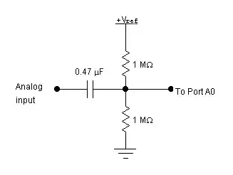

As to possible solutions to your problem - apart from some good ideas given here (e.g. using charge-pump or PWM-based V- generator), I'd like to share one that worked best for me in my designs.
If you want a +/- input, just apply a DC bias to the input signal, possibly using simple superposition circuit based on two resistors and one capacitor. If the input signal's range is (-3V,+3V), add a +3V bias to it by putting high end on 6V and low end on GND.
DC bias
Likewise, if you require a (-3V,+3V) output, you can work your op-amp with positive voltages, and then apply either negative bias or simple highpass filter (single RC would probably do the trick) to the output if you really need it. This way you can use any op-amp with single supply rail, plugging the negative supply to GND.
See here for a simulation showing the idea with single-supply +6V/0V op-amp relaxation oscillator filtered to get about -3V to +3V swing using 1uF cap and 100kOhm res highpass and VGND from two resistors.
The obvious caveat (as with every single-supply solution) is that it requires a virtual GND for any common op-amp application (apart from unity-gain buffer and some simple comparators maybe), but you can do that with either two resistors (with a buffer if more current is required) or one "rail splitter" IC (TLE2426 comes to mind here).

As other answers have mentioned, you cannot create a "negative" voltage with an opamp, given positive rails. You have to realize is that voltage is relative, so what you can do is create a "virtual" ground at Vcc/2, and treat 0V as your negative supply and Vcc as your positive supply.
This can be done using an opamp to buffer a voltage division of your power supply:
For example, if you use a DC power supply of 9V, then your Vcc/2, or virtual ground, will sit at 4.5V. Now, you can use this voltage wherever you had ground in your circuit before, the actual 0V as your negative supply, and 9V as the positive supply. This will also ensure you get that +3V to -3V swing at the output of the opamp, I believe the LM324 clips at about |Vcc-1.5|.
Since you are interfacing with an UNO, you will need to be careful with connecting the output of the opamp to any inputs. The DC offset on the output will be 4.5V and the Arduino cannot handle much above 5V. You could decouple the DC with a capacitor but then the Arduino also cannot handle voltages below 0.

  • it's been proposed already 2 times, see http://electronics.stackexchange.com/a/151568/20088 and http://electronics.stackexchange.com/a/151531/20088 - also, a) since the input signal is -3V/+3V in reference to GND, your idea wouldn't work, since you provided no DC biasing on input, b) you don't need a buffer to have VGND in most cases. –  Jan 30 '15 at 18:56
  • No, OP says the output signal will range from -3V to +3V. I assumed he was referring to the output of the opamp. He says nothing about the input. Yes, I did not mention anything about DC biasing, but you mentioned that in your answer already. I do also provide more intuitive information about how this virtual ground technique works as well as about the UNO. And, since OP has a dual opamp, why not use it? So why the downvote? – Shubham Jan 30 '15 at 19:07
    ->output, a typo. Still, -3V, as well as +3V *always* refer to GND unless explicitly stated otherwise - that's the convention. Either OP's mistaken, in which case the question hasn't many sense, or you're mistaken here. If the signal would go from -3V to +3V with reference to Vcc/2, we'd instead say it goes from Vcc/2-3V to Vcc/2+3V (which is the case you propose); it's *impossible* to get -3V/+3V swing with reference to GND on single-supply op-amp. Saying how to create a VGND doesn't answer the OP's question OTOH. –  Jan 30 '15 at 19:15
  • I guess it wasnt so obvious I meant -3V/+3V relative to Vcc/2. The OP's question was whether you can create a negative supply, and that has also been answered many times. – Shubham Jan 30 '15 at 19:28
