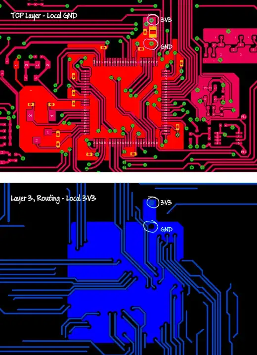

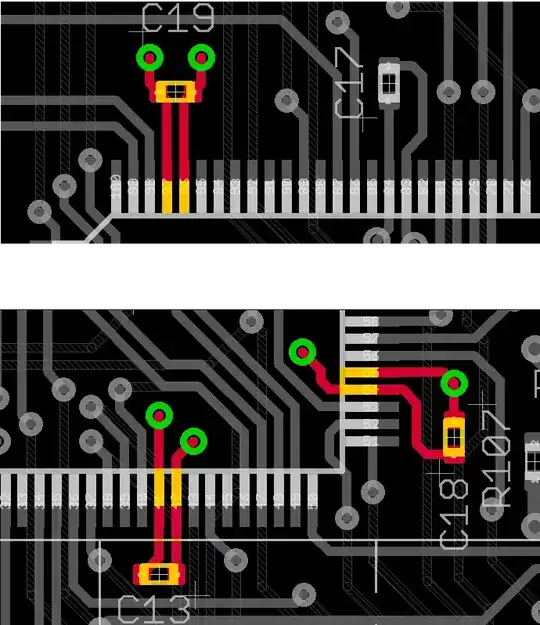

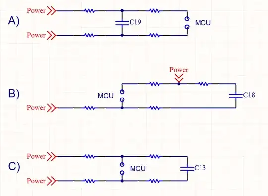

I guess I've been somewhat ignorant when it comes to the finer details of pcb layout. Lately I've read a couple of books that try their best to lead me on the straight and narrow. Here is a couple of examples of a recent board of mine, and I have highlighted three of the decoupling caps. The MCU is a LQFP100 package and the caps are 100nF in 0402 packages. The vias connect to ground and power plane.
placement of decoupling caps
The top cap (C19) is placed according to best practices (as I understand them). The other two are not. I haven't noticed any problems. But then again the board has never been outside the lab.
I guess my question is: How big a deal is this? As long as the tracks are short, does it matter?
The Vref pins (reference voltage for the ADC) also have a 100nF cap across them. Vref+ comes from an onboard TL431 shunt regulator. Vref- goes to ground. Do they require special treatment like shielding or local ground?
EDIT
added local GND and power planes
Thanks for great suggestions! My approach has always been to rely on an unbroken ground plane. A ground plane will have the lowest possible impedance, but this approach may be too simplistic for higher frequency signals. I've made a quick stab at adding local ground and local power under the MCU (The part is an NXP LPC1768 running at 100MHz). The yellow bits are the decoupling caps. I'll look into paralleling caps. The local ground and power are connected to the GND layer and the 3V3 layer where indicated.
The local ground and power are made with polygons (pour). It's going to be a major rerouting job to minimize the length of the "tracks". This technique will limit how many signal tracks can be routed under and across the package.
Is this an acceptable approach?

    C13 is best-practices, C18 is less ideal, and C19 is the *worst*. What are your sources for best practices? – Connor Wolf Jun 07 '11 at 23:35
    The new layout looks pretty good. Yes, local planes can get in the way of routing other signals. Everything is a tradeoff. The local nets don't need to be planes, however. On two layer boards or otherwise where I can't afford local planes, I route the power and ground nets first as regular traces, then let other things route arund them. That's not much worse than a highly broken up plane, and a plane provides less benefit to a local net anyway, compared to something like the board-wide ground. – Olin Lathrop Jun 08 '11 at 13:55
    Well, I am likely unqualified to argue against Olin here, although these suggestions run counter to most of what I feel I've learned about decoupling. Still, those are not planes at all but a highly broken up star grounding pattern. The traces are thicker, but given the 0402 caps they're not that thick. That looks like a lot of impedance to me. Think of the size of the return current loop between the supplied power and ground return. It goes all over the place! Again, underqualified... but it really seems wrong to me. Please, can someone else explain how this is or is not a good idea? – darron Jun 08 '11 at 16:16
    My understanding based on sources like Dr Howard Johnson's books highly favors tight, low impedance coupling to ground. Separate vias for the IC and caps, multiple per cap in critical places. However, given the 0402 size of these caps and a probably reasonable rise-time based on 100MHz I'd think the original design was okay. I'm assuming the other layers make it hard to move the caps closer or add separate vias for them... but it should have been fine. – darron Jun 08 '11 at 16:25
    I don't consider C13 to be best practices. Close, but not best, because all the trace length from capacitor to vias means that C13 is only effectively decoupling those power pins, and is much less effective at decoupling the other power pins on the same voltages. At the very least, I'd move C13 away from the chip enough to move the plane vias in between the chip and C13, shoving signal traces as needed. – Mike DeSimone Jun 10 '11 at 19:57
    Interesting. I thought C19 would be the best, as it places the cap as a low-pass filter between the ripple current source and the power planes – Simon Richter Jul 29 '14 at 14:28
    May I ask how is your local 3.3 layer on layer 3 connected with the global 3.3V layer? Where is the global 3.3V layer? – richieqianle Jan 05 '16 at 13:41

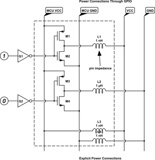

So to bring this back to your layout, what I don't like is that each bypass cap seems to have a separate via to power and ground. If these are the main power and ground planes of the board, then that's bad. If you have enough layers and the vias are really going to local power and ground planes, then that's OK as long as those local planes are connected to the main planes at only one point.
It doesn't take local planes to do this. I routinely use the local power and ground nets technique even on 2 layer boards. I manually connect all the ground pins and all the power pins, then the bypass caps, then the crystal circuit before routing anything else. These local nets can be a star or whatever right under the microcontroller and still allow other signals to be routed around them as required. However, once again, these local nets must have exactly one connection to the main board power and ground nets. If you have a board level ground plane, then there will be one via some place to connect the local ground net to the ground plane.
I usually go a little further if I can. I put 100 nF or 1 μF ceramic bypass caps as close to the power and ground pins as possible, then route the two local nets (power and ground) to a feed point and put a larger (10μF usually) cap across them and make the single connections to the board ground and power nets right at the other side of the cap. This secondary cap provides another shunt to the high frequency currents that escaped being shunted by the individual bypass caps. From the point of view of the rest of the board, the power/ground feed to the microcontroller is nicely behaved without lots of nasty high frequencies.
So now to finally address your question of whether the layout you have matters compared to what you think best practices are. I think you have bypassed the power/ground pins of the chip well enough. That means it should operate fine. However, if each has a separate via to the main ground plane then you might have EMI problems later. Your circuit will run fine, but you might not be able to legally sell it. Keep in mind that RF transmission and reception are reciprocal. A circuit that can emit RF from its signals is likewise susceptible to having those signals pick up external RF and have that be noise on top of the signal, so it's not just all someone else's problem. Your device may work fine until a nearby compressor is started up, for example. This is not just a theoretical scenario. I've seen cases exactly like that, and I expect many others here have too.
Here's a anecdote that shows how this stuff can make a real difference. A company was making little gizmos that cost them $120 to produce. I was hired to update the design and get production cost below $100 if possible. The previous engineer didn't really understand RF emissions and grounding. He had a microprocessor that was emitting lots of RF crap. His solution to pass FCC testing was to enclose the whole mess in a can. He made a 6 layer board with the bottom layer ground, then had a custom piece of sheet metal soldered over the nasty section at production time. He thought that just by enclosing everything in metal that it wouldn't radiate. That's wrong, but somewhat of a aside I'm not going to get into now. The can did reduce emissions so that they just squeaked by FCC testing with 1/2 dB to spare (that's not a lot).
My design used only 4 layers, a single board-wide ground plane, no power planes, but local ground planes for a few of the choice ICs with single point connections for these local ground planes and the local power nets as I described. To make a long story shorter, this beat the FCC limit by 15 dB (that's a lot). A side advantage was that this device was also in part a radio receiver, and the much quieter circuitry fed less noise into the radio and effectively doubled its range (that's a lot too). The final production cost was $87. The other engineer never worked for that company again.
So, proper bypassing, grounding, visualizing and dealing with the high frequency loop currents really matters. In this case it contributed to make the product better and cheaper at the same time, and the engineer that didn't get it lost his job. No, this really is a true story.

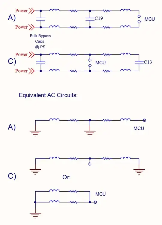

I find it tends to help to think about the equivalent RC circuits the traces form, when you need to consider the behavior of the power lines (traces, e.g. really small resistors) and decoupling caps.
Here is a simple sketch schematic of the three caps you have in your post:
enter image description here There is no polarity in the image, so just assume one "Power" is ground, and the other is VCC.
There are basically two approaches to decoupling - A and C. B is not a good idea.
A will be most effective in keeping noise from the IC from propagating back into the power rails of your system. However, it is less effective at actually decoupling switching currents from the device - The steady-state current and the switching current have to flow through the same trace.
C is most effective at actually decoupling the IC. You have a separate path for switching currents to the capacitor. Therefore, the high-frequency impedance of the pin to ground is lower. However, more switching noise from the device will make it's way back to the power rail.
On the other hand, this does result in a net lower variance of voltage at the IC pin, and reduces the high-frequency power supply noise by shunting it to ground more effectively.
The actual choice is implementation specific. I tent to go with C, and just use multiple power rails whenever possible. However, any situation where you do not have the board space for multiple rails, ,and are mixing analog and digital, A may be warranted, assuming the loss in decoupling efficacy causes no harm.
If you draw the equivalent AC Circuit, the difference between the approaches becomes more clear:
C has two separate AC paths to ground, whereas A has only one.

    I disagree with your distinction between A and C. The low frequency currents from the power supply and the high frequency decoupling currents simply add. The only drawback to A is that the low frequency power feed goes thru slightly more resistance, but that's a DC issue and is fine as long as the correct voltage can be supported. – Olin Lathrop Jun 08 '11 at 11:23
    It is also incorrect to say that A is better decoupled than C. To look at the decoupling component alone, disconnect the power feed. When doing that, both A and C leave you with the same circuit. Decoupling is accomplished just as well by both. The difference is that A keeps the high frequency current components off the power nets better. – Olin Lathrop Jun 08 '11 at 11:25
    For modern high-speed designs, it's better to model inductors instead of resistors. The problem is not that you resistively attenuate, but that the inductance of the power distribution network causes delays that the power supply cannot react to fast enough. (In control loop theory, you find that putting a delay [Laplace transform: e^st] in the feedback path will only help destabilize the control loop.) These delays are due to the fact that the current in an inductor cannot change instantly, and thus the voltage must change instead when a sudden load change occurs. – Mike DeSimone Jun 08 '11 at 13:58
    @Olin Lathrop - I specifically said that A is **worse** at actually decoupling the IC, not better - `However, it is less effective at actually decoupling switching currents from the device` – Connor Wolf Jun 09 '11 at 05:02
    Furthermore, C is **definitely** lower impedance then A. I will have some edits to the answer in a minute to explain. – Connor Wolf Jun 09 '11 at 05:04

Bypass capacitors serve four primary functions:
  1. They minimize rapid changes in the currents drawn on the supply wires (such changes in current draw could cause EMI, or could couple noise to other devices on the board)
  2. They minimize changes in the voltage between VDD and VSS
  3. They minimize voltages between VSS and ground
  4. They minimize voltages between VDD and the board's positive rail
Diagram (A) in Fake Name's answer is by far the best one for minimizing changes drawn on the supply wires, since changes in the current drawn by the CPU will have to change the cap voltage before they can cause any change in the supply current. By contrast, in diagram (C), if the inductance to the main supply were ten times that going to the bypass cap, then the power supply would see 10% of any current spikes regardless of how big or how perfect the cap might be.
Diagram (C) is probably the best from the perspective of minimizing changes in the voltage between VDD and VSS. I would guess that it's probably more important to minimize variations in the supply current, but if it's more important to keep the VDD-VSS voltage steady, diagram (C) might have a slight advantage.
The only advantage I can see for diagram (B) is that it probably minimizes differential voltage between VDD and the board's positive supply rail. Not really much of an advantage, but if one were to flip the rails, it would minimize the differential voltage between VSS and ground. In some applications that could be important. Note that artificially increasing the inductance between the positive supply rail and VDD might help reduce the differential voltages between VSS and ground.

There's a yet another trick in minimizing the impedance between the internal GND and VCC rails in the MCU, and the power planes.
Every unused MCU I/O pin should be connected to either GND or VCC, chosen so that roughly the same number of unused pins goes to VCC as to GND. Those pins should be configured as outputs and their logic value should be set according to what power rail the output is connected to.
That way you provide extra connections between the MCU's internal power rails and the power planes on the boards. These connections simply go through the package inductance and ESR, and the ESR of the mosfet that's turned on in the GPIO output driver.
This technique is so effective at keeping the MCU's interior tied with the power planes that sometimes it pays to choose the a package for a given MCU that has more pins than needed, just to increase the number of redundant power pins. If your board manufacturer can tackle it, then you should also prefer leadless (LCC) packages as they usually have lower board-to-die inductance. You might want to verify that by consulting the IBIS model for your MCU, if there is one.
  • What about the risk of shortcircuits (e.g. due to a software error)? – Peter Mortensen Jan 13 '16 at 00:55
    @PeterMortensen Such wouldn't be catastrophic. The pin drivers are effectively current sources. If you mess up, all that happens is your MCU runs hot and you might go over absolute current or dissipation ratings if you're particularly unlucky. Your software shouldn't act up. If you expect significant problems from it acting up, code as if it were a [Class B](http://www.microchip.com/pagehandler/en-us/technology/homeAppliance/classbsafetysoftware.html) safety software. The background consistency checker will catch wrong pin states and act accordingly. – Kuba hasn't forgotten Monica Jan 13 '16 at 14:18
Even though your design "works" as is, in my experience, I found out that if you don't do a "good" job at decoupling and bypassing, your circuits will be less reliable and more susceptible to electrical noise. You may also find that what works in the lab, may not work in the field.
Guill
  • 2,430
It's always best to adopt good practice, especially as it doesn't involve any more work or cost in this type of design.
You should have the vias as close as possible to the capacitor pads, to minimise inductance. The capacitor should be close to the supply and ground leads of the chip. The routing in the second image should be avoided, and the first isn't ideal. If that is a prototype, I'd modify the decoupling for the production version.
Apart from the chip malfunctioning in some circumstances, you could be increasing unwanted emissions.
