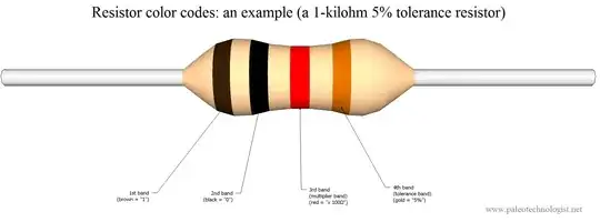

Here is an example of how these codes would be read on a garden-variety 1-kilohm (or “1k”) resistor. Reading the bands from the left, the brown band represents 1, and the black band represents 0. Putting these together gives “10” for the base value. (The first band is almost never black, except in the unusual case of a “zero-ohm” resistor: a single black band, otherwise known as a “wire.”) The third band is the multiplier band; red signifies multiplication by 100, making the total value 10 x 100 = 1,000 ohms — or “1k.” The 4th band is the tolerance band; gold signifies that the true resistance value of this component should be within 5% of the stated value (950 to 1,050 ohms).

s3v3ns
  • 220
  • Thank you. That's a very helpful answer to _how_ to read a resistor-- but my question is _why is the first band never black_? – Michael Hoffmann Jan 28 '15 at 07:14
    Quoting my own post (The first band is almost never black, except in the unusual case of a “zero-ohm” resistor: a single black band, otherwise known as a “wire.”) – s3v3ns Jan 28 '15 at 07:14
