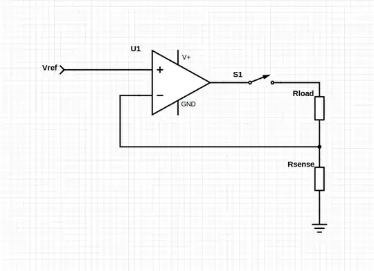

How can an op amp be prevented from going into saturation if the feedback is intermittently disconnected?
For example, in this circuit (simplified case of a real-life problem), the op amp acts as a current source to a load, but the load may be disconnected sometimes.
When the load is disconnected, the op amp output goes to the positive rail and the op amp goes into saturation. When the load is reconnected, the op amp takes extra time to start regulating current) and then slews to the expected current set point. Depending on the op amp, the time to recover from saturation may be very long. The current through the load is the maximum possible for that time (ouch).
How can saturation be avoided in this case? Are there some additional components to a feedback network that would do it? Perhaps some kind of input or output clipping circuit? Are there op-amps that would inherently limit their outputs (or inputs) some voltage away from the rails using built-in circuitry?

  • Isn't it usually a bad idea to disconnect the load from a current source with an open circuit? Your circuit is trying to force a constant current through an infinite impedance, which requires infinite voltage, hence you get saturation. – DaveP Jan 28 '15 at 02:38
    @DaveP: You sometimes have to. For example if it's a pluggable device,, or in my case if you need to switch the load between the current source and something else. – Alex I Jan 28 '15 at 10:07
A zener diode connected from op-amp output to inverting input (possibly with a series std diode) and NOT switched by S1 plus a resistor from Vsense to inverting input will limit Vout+ excursion. If this is dual supply then back to back zeners will do the same thing symmetrically.
When Vout approaches Vzener negative feedback is provided. The resistor from OA- to Vsense needs to be large enough for the zener to dominate with minimal effect from Rsense.
A 1K should be fine but something like 100 x Rsense for low values of Rsense should be an OK compromise. Zener leakage at low output deviations should be "low". A more elegant solution implementing the same principle with more complex circuitry would yield truly minimal effect when the load is connected.

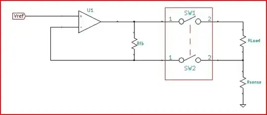

The only way to keep the OpAmp from saturating is to provide an inner feedback loop.
This could be done by changing the switch to from a SPST to a DPST type and adding a local feedback resistor Rfb.
When SW1 and SW2 are open feedback would be provided by Rfb. Value of Rfb would be much larger than that of RLoad so that with the switches closed, RLoad and Rsense would dominate. For example if RLoad were 1k Ohm, Rfb could be 100k Ohm.

The easiest solution would be to parallel the load with some kind of nonlinear network such as two series Zener diodes, two back-to-back LEDs or two diodes. Of course the leakage would take current from the load, so that may or may not yield acceptable performance.
Op-amps that limit are available, but they're not all that common. You may also be able to find a conventional op-amp with a short recovery time.

  • I see! In my case the load draws a significant amount of power, so paralleling it with anything (that would maintain meaningful feedback) is not practical. But paralleling Rsense with a diode looks possible :) – Alex I Jan 27 '15 at 23:21
You should examine why you are disconnecting the opamp from its load in such a manner. If you want to shut down the current, driving the positive input to 0 would be better.
What are you trying to accomplish overall? Why do you think you have to break the connection between the load and the output of the opamp? Step back two levels and explain what's really going on.
