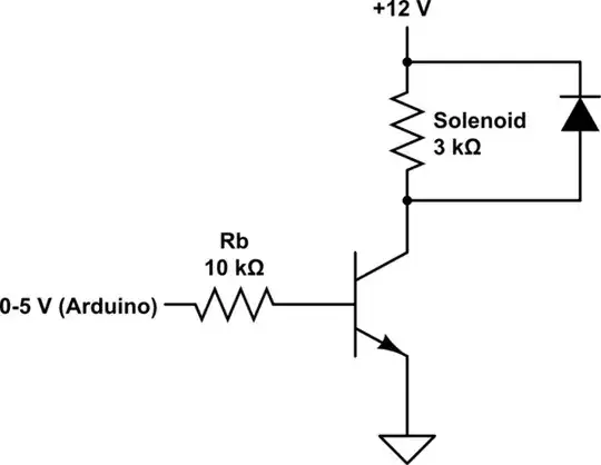

    Your diode is upside down – Mike Jan 27 '15 at 16:28
  • This schematic is hard to read with things being sideways and overall random layout. The arduino output is also shorted to one side of the supply, which is unlikely correct. Closing this mess. Also, if you have to mention arduino for the question to make sense, then it doesn't belong here. – Olin Lathrop Jan 27 '15 at 16:28
    Tip for schematics: it's a lot easier to read circuits where power (like your 12 V source) travels from top to bottom and signals travel from left to right. This is part of what Olin means about "things being sideways." – Greg d'Eon Jan 27 '15 at 16:40
  • Replace the two 180K resistors on the transistor base with a single 10K (or less) resistor. You need to saturate the transistor, not restrict the collector currrent. – Peter Bennett Jan 27 '15 at 16:40

  • @PeterBennett, ok, I had used the Rb = (Vin - Vbe)/Ib equation, but I'll give that a shot. Thank you. – wes3449 Jan 27 '15 at 16:44

    On the technical front, is there any chance your actuator incorporates a permanent magnet and so requires a particular polarity? Will jumpering across the transistor close it? Is the transistor in backwards? – Chris Stratton Jan 27 '15 at 19:38

It looks like there are some issues with your circuit. Summing up the comments:
  • Your diode has the wrong polarity to stop back-emf
  • Your base resistor is too large
Here is an updated schematic with these fixes.
You could also take a look at this answer to see a bit more info on driving a solenoid.
