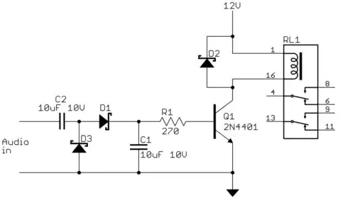

When you don't have a series nor a parallel you can't just swap things around and hope things will still work, as someone said in a comment think of a simple CE bjt amplifier:
courtesy of the big web
You may look at it and say hey! R1 and R2 are in series, I can swap them. No, you can't because they are not in series because the current that flows in R1 is not the same that flows in R2.

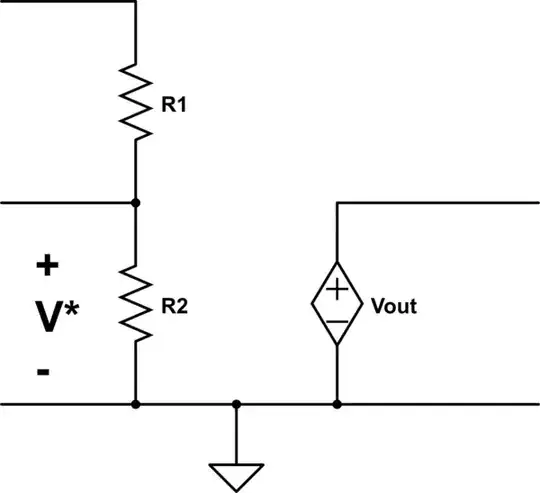

Another case is when you need to measure either the voltage across a TTC in a series or the current through a TTC in a parallel. Maybe that voltage/current controls some other quantity around your circuit and if you don't be careful enough you might end up with wrong results:
simulate this circuit – Schematic created using CircuitLab (Sorry, that image sucks but the editor randomly places labels around.)
Suppose that the top terminal of R1 is connected to some fancy circuit and that \$V_{out}=kV^*\$. Please note that R1 and R2 are in series, I've drawn a wire coming from the middle of them but no current flows there, so the current that flows in R1 is the same that flows in R2. But what happens when you swap R1 and R2? Well, of course \$V^*\$ changes! If your fancy circuit outputs some current \$I_{fancy}\$ in the first case \$V^*=I_{fancy}R1\$ while in the second \$V^*=I_{fancy}R2\$, and these may differ of course.

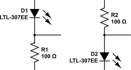

Resistors in series with other components are, themselves, transitive. They can be swapped with other components in the uninterrupted series and they will react the same. However, the other components may not like being swapped.
From the resistor's point of view, the current is the same regardless of the position. Since the LED is a current device, it won't be affected by the swap.
If you "tap" the connection between the resistor and the LED, though, then you are sure to get a different voltage depending on the position of the resistor relative to the LED - this is no longer an uninterrupted series circuit, but has some parallel aspects. In this case you can't necessarily swap them without affecting the circuit - specifically the voltage at the tap and the new parallel circuit created by that tap.
The above two circuits will operate the same in every use case you will run into as a programmer.
The above two circuits will be different depending on where that wire goes off to the side.
You can apply the same principle to many other two terminal devices next to resistors as long as you observe polarity when doing the swap. If there is no wire coming off between two items in series, then swapping the two is likely to have little effect on the overall circuit.
