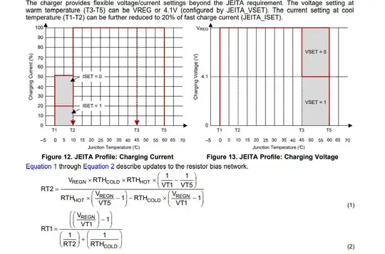

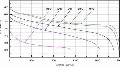

No, you cannot do this. If you charge to 4.2V at 0 degrees C, and then put the battery in a 30 or 40 degrees C environment, it will explode from being severely over-charged. This is because the fully charged voltage is temperature dependent. See graph below.
I learned this from experience, it's how the cheap Chinese USB solar chargers work, and they will explode in your car if you leave them in there over a 1 year period and don't use them much. This is because they charged to 4.2V at the coldest point in winter, and once summer comes along, the cell voltage rises to 4.7 or higher, and the battery pressure then exceeds the limits of the packaging, and if you are lucky, it won't catch fire, but just puff-up (lithium polymer) and off-gas like mine. I measured the cell voltage with a multi-meter and it was 4.7V.
https://www.richtek.com/en/Design%20Support/Technical%20Document/AN024
Also, just to further illustrate how you are going down the wrong path, take a look at a typical Lithium Ion charger, such as bq25601, and you will see the charge profile is dependent on temperature. If you are building a voltage regulator charging circuit into a customer product, it will not be safe. If you are just tinkering around at room temperature, then fine.
enter image description here https://www.ti.com/product/BQ25601
If you want to look more at safety regulations, here's a list of them: US: From UL-1642 EU: From IEC61233 Japan: JEITA
The latest specs are behind paywalls, but you can find free example certification test forms.
Dave
  • 59
  • @Dave Please provide a reference for the image – Voltage Spike Aug 16 '21 at 18:49
  • Is temperature compensation difficult with a small number of cheap, common parts? – johny why Jun 04 '22 at 10:43
  • This answer seems to have nothing to do with the question. This answer communicates that the proposed charger should ALSO incorporate some form of temperature compensation. This caution doesn't in itself invalidate the proposed charging method. – johny why Jun 05 '22 at 19:47
