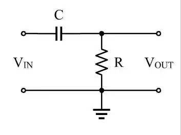

Consider, for example, this circuit from Wikipedia:
What the hell is that resistor doing there? Surely all that does is short-circuit all the power, such that no current reaches the other side at all.

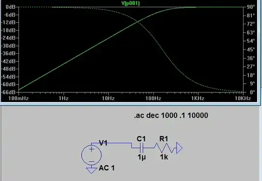

Let's look at some simulations. Say you have a 1uF cap, and your load is 1k:
Filter with smaller resistor, larger current
(Ignore the phase plot, as it's irrelevant for this post). OK, we have a rolloff starting around 200Hz. That's alright, I guess, if that's what you want. But what happens when the resistor changes? I.e., what happens when your circuit wants a different amount of current?
Filter with large resistor and small current
Goodness! Our 3dB point is now around 1Hz. So our "filter" is moving all over the place whenever something in your circuit wants the current to change! It's totally unpredictable.

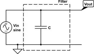

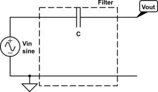

I know that you already have got many answers. Let me try my own way.
What I have to design is filter. Both low-pass and high-pass. What I have is a capacitor only.
Consider the first implementation, where all the components are ideal.
When Vout is measured using an ideal oscilloscope, What we would get is Vout = Vin.
So this circuit can not work as any filter.
Considering second implementation,
Here, there is no current through C and hence here also Vout is Vin.
So the second circuit also can not work as a filter.
So one can not implement a filter only with capacitor (at least in ideal case).

In the high pass filter/edge detector (first circuit), the resistor is there to form a voltage divider with the capacitor. Capacitors grossly said act like frequency-dependent resistors (they also phase shift the signals but let's let that slide). The resistor is there to create a voltage that depends on frequency without drawing any current: at high frequencies the impedance of the capacitor will decrease and you get more of the input out (and vice-versa). So without that resistor, if no current is drawn the input will be mirrored in the output (no voltage drop).
In the low pass filter the resistor is also there to form a voltage divider except that this time, the voltage of interest is that across the capacitor ("gets stronger with time" => low pass) and not the image of the current ("gets weaker with time" => high pass). If you short circuit the resistor the capacitor will react too quickly and will be useless as a filter, just like I mentioned at the beginning of this post.

If the time to fully charge the capacitor is longer than the wave period,
But how long is that time? It turns out to take \$R \cdot C\$ seconds to charge to approximately 2/3 (charging is asymptotic). This is called the RC time constant.
If you take the resistor out of the first circuit, and have nothing at Vout, then you don't have a circuit - there is no loop round which current can flow. In reality, if you put say a meter or an audio input there then it will look like a resistor of a few megaohms. The current flows through the capacitor, through the meter, and back to the negative rail. Putting a specific resistor there gives you a predictable sensibly-sized resistance to calculate with. It doesn't divert power - in fact by ohm's law it develops a voltage across it in proportion to the alternating current flow.
In the other example, the series resistor is there otherwise Vout would always equal Vin; it delays the charging of the capacitor to a specific time constant.
An inductor on its own is called a "choke" and is indeed an effective lowpass filter. It's never entirely on its own, there is always a few picofarads of wire capacitance around..
(Your question conflates voltage, current and power carelessly, which may be confusing you)

If there is no actual or implicit resistor in your circuit, you are driving the capacitor with either an ideal voltage source, or an ideal current source. Putting a resistor in series with an ideal current source is pointless, so the only interesting case is the one with an ideal voltage source.
The point of the ideal voltage source is that the capacitor will follow the voltage immediately. And that means that the current into the capacitor will be \$d/dt U * C\$. A jump in voltage will result in infinite current spikes.
The usual purpose of an RC element, however, is not as a differentiator but rather as a delay element. Putting a resistor in series will limit the current and thus stop the capacitor from tracking the voltage immediately.

Let's do a simpler, more effective, approach...
But first:
This is incorrect in two main points:
  • Shorting means making two points the same voltage (in reference to ground), which is clearly not the case here: Assuming the resistor's value isn't zero, the voltage across the resistor is not zero.. unless the current through the resistor is. Since the voltage across the resistor is V=R*i. If one of the two is zero, then the voltage is zero.
  • Even if it was a short circuit, there would still be a current (but no voltage, since the voltage across a "short/wire" is zero. So V=R*i. Assuming it's a short (R=0), there can be a current flowing and the voltage would still be zero...
Now...
Let me ask you a question.. In the first circuit (assuming R is not zero), what would make the voltage zero? Well, no current.
And assuming you're applying a voltage across your input (at your left), why would there not be a current?
Because the capacitor is preventing current flowing.
And in which case the capacitor would do that? In which case any component would prevent current from flowing?
Answer: When a component has an impedance of infinity..
See: V=Z*I.. So I = V/Z, right?
So if Z = Infinity, then you have a null current... In other words, your component becomes equivalent to an open-switch..
Now: When does a capacitor behave that way? In other words, when is the impedance of a capcitor infinity? Well Zc=1/(jwC)..
Assuming C is not zero.. That leaves omega = 0... In other words, what you call "DC". Frequency zero.
So, let's call "gain" the ratio between the voltage at your output and input..
G= Voutput/Vinput..
When omega = 0, capacitor behaves as an open circuit, meaning your current doesn't even "make it" to your resistor, meaning volage across R (which is Voutput) is 0..
Which means G=0/Vinput=0.
Okay.. We saw the case for omega = 0..
What about omega = infinity?
Well, the capacitor then behaves as a closed switch.. Which means: Vinput=R*I=Voutput.
Which means G=1.
So.. Our circuit's gain is 0 in the low frequencies, and 1 in the high frequencies... In other words, it lets high frequencies pass, and blocks low frequencies.. In other words: A High Pass Filter.
Can we do our second circuit?
Omega --> 0 ===> Capacitor is open circuit (remove it from your schematic). All you're left with is Vout = Vin.. So gain G = 1.
Omega --> Infinity ==> Capacitor is a short circuit, and Vout = 0, so G=0.
In other words, that circuit lets signals of Low frequencies pass, and blocks high frequency signals..
It's a Low Pass Filter..
