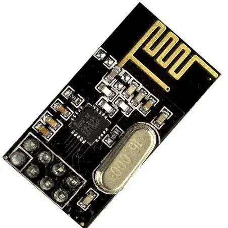

I'm currently using the "naked" chips, which look like this: naked

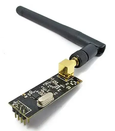

I've seen them with "rubber-ducky" antennas before, though: antenna

My question: Would adding an antenna on top of the flat antenna help with my propogation issues? If so, how would I go about attaching the antenna? Would standard leaded solder do the trick?

  • Have you considered getting an nrf24 that includes a PA/LNA and antenna connector? Adding an antenna by hand is not easy. I've done exactly what you're talking about. It worked, but not well. – curtis Jan 19 '15 at 20:08
  • @curtis: I would totally consider it, but I'm just doing a proof of concept for a project. All I need is a few extra feet of range to get around that corner—if and when I actually deploy the project, I would invest in some new RF24's, but for now I'd like to use what I've got. Would you mind going a little in depth about how you attached the antenna? Thanks! – afischer Jan 21 '15 at 12:19
  • I cut the trace where I thought the 50ohm interface was and the antenna started. On the naked nrf24, my guess would be right after the shorted stub, but that's just a guess. Then I soldered the center conductor of the whip antenna the the trace and the braided shielding to a ground pad. Performance will depend on selecting the correct spot to cut and how clean you can solder the new antenna without peeling the ground back very far. Mine was ugly and didn't work well. Good luck – curtis Jan 21 '15 at 22:05
  • The ground pad is barey a ground. Just find out the wavelength and cut a (half-wavelength) dipole for it. Each leg is a quarter wavelength then. The dipole will provide a far better ground than some tiny pcb tracks. For best reception make sure the ends of the dipole are not pointing to where you want to communicate to. – captcha Mar 01 '15 at 21:30
I cut the trace near that resistance and soldered a +- 10cms,1.5mm copper wire. its working since 2 weeks ago perfect on Arduino with reed switch at 60m distance from the other Arduino.
