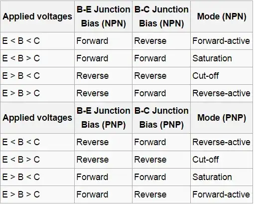

However the problem is I want to put the BJT into saturation mode of operation using this configuration. I found this table on wikipedia, that shows what voltages should be applied to what contant for different modes of operation:table
I can understand the table, but have problems calculating the resistor values. Here's what I do know (for saturation):
  • Q1 collector current \$I_c=700mA\$
  • D1 voltage drop \$V_f=1.4V\$
  • Q1 CE voltage drop \$V_{CE}=0.3V\$
  • Q1 BE voltage drop \$V_{BE}=0.95V\$
Using these values how can I calculate resistors needed to put the transistor into saturation mode of operation?
Could you provide more general details about the calculations, that could work for any mode of operation.
