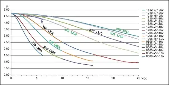

I see this question has been answered but I'll mention a couple of things. Firstly SMT X7R, X5R capacitor voltage ratings and how capacitance changes with applied voltage. Take a look at this: -
It's telling you that the actual capacitance of a lot of common capacitors varies significantly with applied voltage level. If you need capacitance to be stable with varying voltages then use a better capacitor or one that is rated for higher voltage (% change in C is much less).
Article that shows this is here

  • Out of curiosity, do you have any idea whether it would be possible to produce a cap whose capacitance was maximized as some voltage other than zero? An XSR cap is analogous to a water tower which is very fat at the bottom but narrow at the top; it's much more useful, however, to have a water tower be fat at the top and narrow everywhere else. Putting a battery in series with the cap would reverse things, but none of the electrons from the battery would have to go very far (net charge flow through the cap would be zero). Perhaps using different metals for the anode and cathode... – supercat Jan 15 '15 at 20:35
  • ...might yield behaviors somewhat analogous to having a battery in series? – supercat Jan 15 '15 at 20:36
  • @supercat I'm no expert on 'em - I just use them and get caught out by 'em every now and then! – Andy aka Jan 15 '15 at 20:40
  • @supercat Should be possible if you apply a high voltage as the ceramic cools through the [curie temperature](http://en.wikipedia.org/wiki/Curie_temperature#Curie_temperature_in_ferroelectric_and_piezoelectric_materials), but then the cap would be polarized. – Spehro Pefhany Jan 16 '15 at 04:34
  • @SpehroPefhany: Polarization would be implied in such a scenario; I wouldn't generally expect a cap to have a low capacitance when the differential voltage was small, but a high capacitance when biased in either polarity interchangeably (though thinking about it, such a thing could occur with microphonic effects, though probably not in such a fashion as to improve efficiency). For intermittently-powered circuits, applied voltage would go between zero volts and nominal voltage, so having a polarized part wouldn't be a problem. – supercat Mar 11 '15 at 17:16
