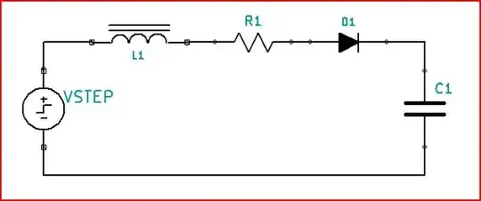

The most simple example of edge resonance is a voltage step driven RLC with diode circuit.
You probably know that the Q of this circuit is \$\frac{Z_o}{\text{R1}}\$, and as long as R1 has a value that allow Q > 5, the circuit will be very under damped (highly resonant). If a step input is applied, voltage on C1 will ring up to ~ 2Vstep. At that time current in L1 will be zero. D1 blocks any discharge of C1. That's a resonant rising edge. Replace the diode with a well timed switch and you can get a resonant falling edge as well. This may seem a trivial example, but all edge resonance is based on the same dynamic.
