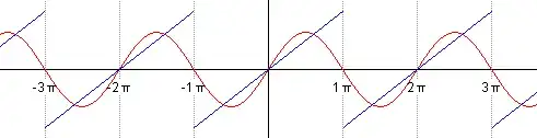

They say a picture is worth a thousand words. And a handful of animated pictures...
All of these from Wikipedia. You can see these in context in the articles for Fourier transform, square wave, and Fourier series.
As it turns out, any periodic waveform can be represented by a Fourier series, although to represent it exactly may require an infinitely long series. In engineering practice, however, above a certain point continuing the series adds no additional useful precision, and we can call a finite series "good enough".
