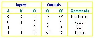

Just i will remind you the truth table of JK-flipflop:

here use these inputs to the this circuit by considering the previous state then
you will get the output as same as that as the input you given to the D-flip flop
thats it but it doesn't means it won't use the previous state.
