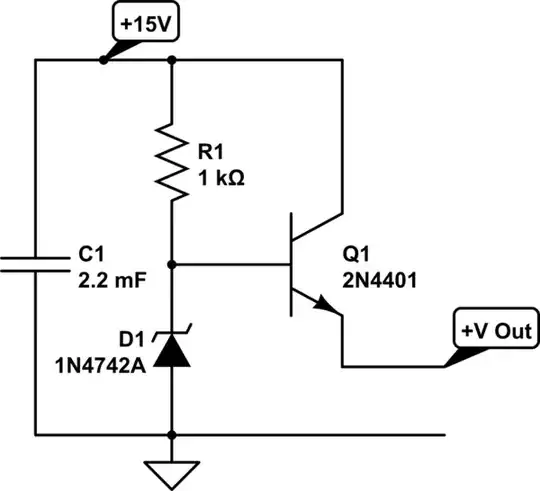

If you need a permanent non-jumper solution - consider protecting your analog voltage source with a simple resistor and a zener. The image shows your source on the left, and your PIC on the right. For a 5v setup, perhaps a 5.6v zener could be used?
The user manual for pickit recommends typical 450ohms pullup to protect Vpp - which gives roughly 12-5 volts over 450 ohms = 16mA load on the programmer.
To protect for similar current in this setup, let R = 12-0.7V over 16mA = minimum 720Ohm - i.e. 820Ohm. The zener will need to tolerate 0.7V * 16mA = 11.2mW - and your input must tolerate 5.6V supplied to its input and should have >> 820Ohm impedance...
If you need to fine tune the threshold, use a smaller Zener value, and add forward biased diodes on the zener cathode to lift in increments of 0.7V (depending on diode used)
