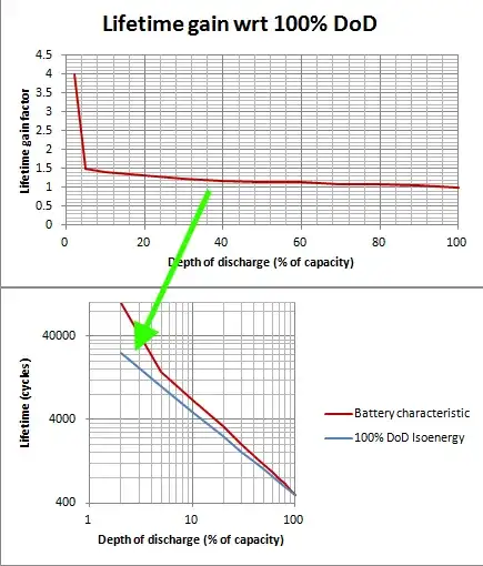

My quick look into it:
The lifetime of lithium batteries decreases with the depth of discharge, looking like the following (this curve is for lead-acid batteries, but Lithium is stated as following a similar curve): enter image description here
(source)
If the 100% DoD value is taken as a reference, one can plot what I call the "isoenergy" curve (I gave it a 2sec thought) which is basically how many cycles are required from the battery to deliver the same amount of energy as 100% discharges over its entire lifetime: $$isoenergy(DoD)=\frac{100\%DoDlifetimecycles}{DoD}$$ For example, 50% DoD require twice as many cycles as 100% DoD, 25% four times etc.
The results with this particular example:
Conclusion, it still holds that the depth of discharge should be minimised as much as possible.

I agree that you get a gain in whole of life capacity with decreasing DOD - from memory the figures that I have seen suggest a greater gain with decreasing DOD in the say 10%-80% DOD range - but I won't guarantee my recollections to be correct.
However, there are several other factors that may be more important and/or useful.
If you are in a position to tolerate reduced capacity discharges and/or multiple recharges per day, better gains may be obtained by limiting the top end of charging.
LiIon cells are usually charged in a CC/CV mode with CC usually at C/1 rate and with Vmax (typically 4.2 V/cell) being reached at around 70%-80% of total capacity, with the balance being input in CV mode at reducing current (set by the battery chemistry). Charge termination occurs at some selected Imax x k with (0.05 <= k < 1)
K = 1 corresponds to terminating charging at the CC/CV transition. It is well recognised that smaller values of k give somewhat increased total energy capacities but disproportionately decreased life cycle. k is quite often set at 0.25 or even 0.5, aggressive charging may set k to 0.1 or even 0.05.
Your curves suggest that even at a usually unacceptably low DOD of 10% total lifetime energy stored in less than 50% more than with 100% DOD. I have not got time at present to locate references but I am (essentially :-) ) sure that gains of better than 50% are gained by use of k=1 (no CV cycle) and this has the bonus of very fast charging (under 1 hour)(eg 48 minutes at C/1 from fully empty if CC/CV transition occurred at 80% energy level). Discharge to 100% DID is also "not helpful" and setting some minimum DOD with this sort of scheme is also useful. Some thing like 20% to 30% remaining capacity and 80% max capacity still returns 50% to 60% of overall capacity, leaves a 20% to 30% emergency buffer when needed and is liable to be superior to simple bottom end DOD control.
