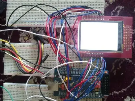

I have an 2.8" LCD that it's controller is ILI9325. I'm trying to use it. for start off, I have written a simple program. the program is this:
#include "stm32f10x.h"
#include "ILI9325.h"
int main(void)
    uint8_t b,c;
    Lcd_Configuration();
    Lcd_Initialize();
    Lcd_Clear(0xffff);
    Lcd_Clear(0x0000);
    Lcd_Clear(0xff00);
    for ( b = 0 ; b < 200 ; b++ )
        for ( c = 0 ; c < 200 ; c++ )
            DrawPixel( b , c , 0xffff );
    test_color();
    /* Infinite loop */
    while (1)

All pins of the LCD are connected to MCU and supply like this schematic:
VCC-------->3.3v
GND-------->GND
LED_VCC---->3.3v
LED_GND---->GND
Y(-)------->not connected
Y(+)------->not connected
X(-)------->not connected
X(+)------->not connected
IM0-------->not connected
RD--------->PC13
WR--------->PC10
RS--------->PC9
CS--------->PC8
RSt-------->PC12
(D1-D8)---->(PC0-PC7)
(D10-D17)-->(PB8-PB15)
As you can see its interface is 16bit. for 16bit interface, if you see page 10 of ILI9325's datasheet you will see this:
figure1
And page 26:
figure2
But lone IM[3:0] pin that I can see is IM0. by the way I think my circuit should work but when I trun on the circuit, lone thing that I can see is this:
figre3
Just a white background! damn it! What's the problem? in your opinion why doesn't my circuit(LCD) work?

There may be a thousand reasons why the LCD is not working.
It could be one of these for starters:
  1. Not fully understanding the documentation.
  2. A connection problem.
  3. Any one of a number of problems with the software algorithm.
  4. A signal timing problem of not meeting protocol requirements at the display.
  5. A signal integrity problem due to voltage level errors, ringing on signal lines due to long wires or power suppply issues.
  6. Improper treatment of the LCD bias voltages. Especially a problem if generated on board but require proper capacitors attached to some signal pins and the bias generator to be configured properly.
I can tell you from direct experience that it is a rare day that firing up a new LCD module, particularly graphics ones, will just start working. It can be a slow and painstaking process.
One of the first things that you have to do is to work at a very low level and make sure that all the interface signals look good and have correct timing.
Next try to convince yourself that you are actually communicating with the display controller. This can sometimes be done by writing some register and then reading it back to see that the written bit values come back. Other times it may be necessary to write one register and then read back the BUSY status to see that it toggles to BUSY and then back to not busy.
Michael Karas

  • Ok, I will check it again. – Roh Jan 02 '15 at 07:36
  • @Roh - For the low level investigation an oscilloscope is an essential tool. Also note that if any part of the display controller documentation is confusing or vague do not hesitate to bring it here as an additional question. – Michael Karas Jan 02 '15 at 11:23
  • Thanks Michael. one vague part is that my LCD just have IM0. I mean I cannot find IM1, IM2 and IM3 pins on my LCD's pin-out. in fact I don't know why there are not IM1, IM2 and IM3!? – Roh Jan 02 '15 at 11:36
  • I suspect that you are seeing the IM0 -> IM3 pins in the LCD controller chip data sheet. However you find the singular IM0 on the range of connection pins to the LCD module. It is very common that the designer of a module board (or LCD glass in case of a COG type display) to tie off certain chip pins (high or low) to configure the chip so that it is specific to module design. If the module manufacturer has done a decent job they will document this in their module data sheet - but often the module documentation sucks and you have to figure out things by experiment. – Michael Karas Jan 02 '15 at 11:43
    @Roh - Another thing to consider...I see that a large amount of the code that you show appears to have come from someplace on the web. It is often that people post code that is not 100% working code. Also someone may have made code for a particular display controller IC chip but maybe they were using a different LCD module than you. There could be chip configuration differences from one module to the next. For both of these reasons it is really necessary to not trust any of the code that you downloaded and go through it with a fine comb and check and understand every line and every function. – Michael Karas Jan 02 '15 at 11:51
  • Aaaammm... good point +1 Ok, let me to check the codes and its configuration. also it's not a module. it's an adaptor. – Roh Jan 02 '15 at 12:06
