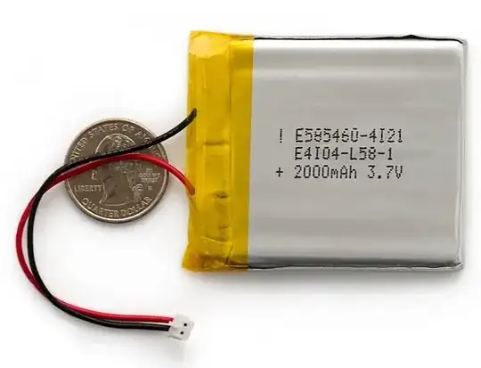

Using a LiPo battery from sparkfun is easy as it comes with a molex connector on it. enter image description here

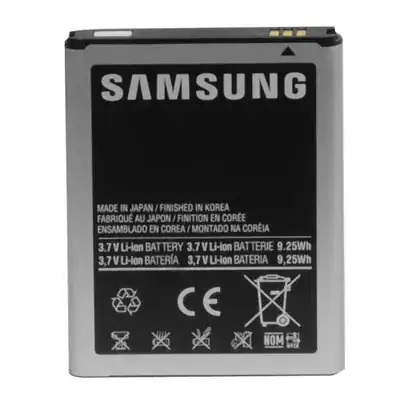

But how to conveniently connect to a LiPo battery taken from a cellphone? enter image description here
Soldering doesn't work on the exposed terminals of the battery.
I've tried to tie up with sticky tape and thread and glue, but its very unstable/unusable, a slight vibration ruins the connection.
Does anyone here know a better/convenient/stable way of connecting such battery to a circuit?

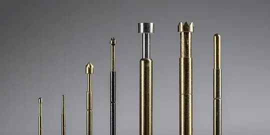

You can make spring loaded contacts using "pogo pins" - test pins made for bed of nails testing. These have contacts which come in various styles including needle point and wider flat circular contacts and these push into a spring loaded base which can be soldered into a carrier of your choice (Vero board or PCB or ...).
Many examples of pogo pins in use with some good (and bad) DIY examples.
Wikipedia - pogo pin
Probe and spring alternative
Rather nice (looking) low profile versions. Source unknown (so far).
From here
http://i01.i.aliimg.com/photo/v0/152605471/pogo_pin.jpg
Typical DIY use](http://www.makerdyne.com/blog/wp-content/uploads/2013/06/Pogo-[Pin_Breakout_Board_Tester_08.jpg)
Stack Exchange related Q&A with some good examples of pp styles & use
For sale fom ADAFruit
Various styles with video related to that image.
Some very nice3 looking low profile examples from here.
Expect to pay as a factor of niceness^n.

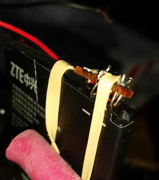

There are a whole load of connectors for sale on AliExpress: http://www.aliexpress.com/cp/phone-battery-connectors-online-shopping.html
Otherwise I think a couple of protuberances made of solder on a small piece of stripboard might be held in place with an elastic band. I might do this soon and take a picture to illustrate what I'm trying to convey (or I might forget about it altogether).
Edit: Okay, the protuberances of solder didn't work but I made some contacts out of bent wire (e.g. from electronics component legs or sewing pins with the ends clipped off) which I soldered onto the stripboard and held on with an elastic band. I can shake it around pretty vigorously without the contacts breaking but if anything were to physically nudge the contacts then they might separate.
Metal wire in stripboard creates contacts for mobile phone battery Metal wire in stripboard creates contacts for mobile phone battery

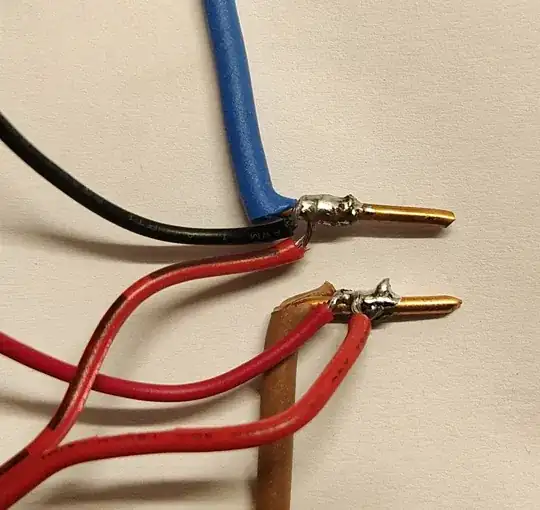

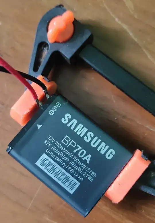

dyi spring loaded connector
This is my version of the spring loaded connector. The cables are from jst connector. I bend the pin to make it just like the connector inside the phone.
The battery is from a camera and I just need to charge it then put it back to the camera, so I cannot solder it.
After the connector firmly held by the clamp, I charge it with my b6ac charger.

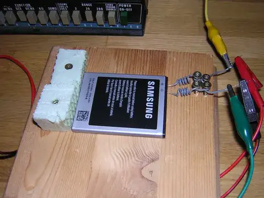

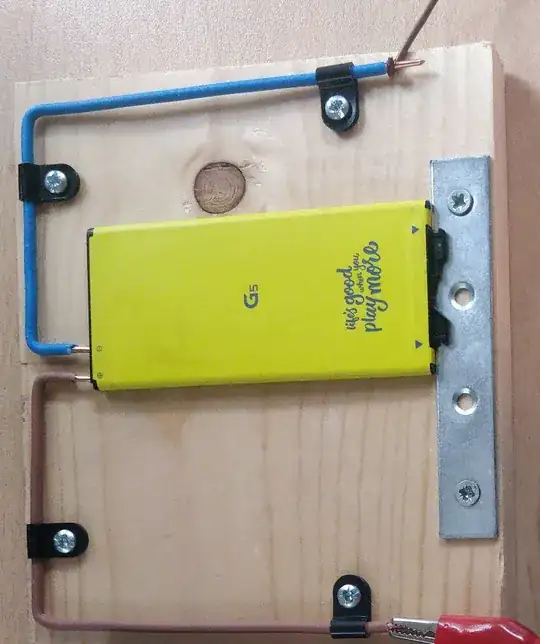

Ok, here's my offering. The "basic" version is made from the 2 solid cores from a 20cm piece of "twin solid core" cable. I used wires with a cross-sectional area of 2.5mm² (approx 1.8mm diameter or 14 AWG) because it is a "standard" domestic cable size in the UK, but I'm sure you could use a lighter/thinner wire instead. Each wire is held in place by 2 black plastic P-clip cable clamps (3.3mm to accomodate the wire insulation), and the natural rigidity (springitude?) of the wire keeps the ends pressed against the battery terminals. I attached a zinc-plated "mending plate" to the back board to keep the battery in place, thus:
Basic version
I then modded each "wire-end" into a "Kelvin probe" by just soldering on the 2 relevant wires:
Wire-ends converted to Kelvin probes
Now I can use my rig for accurate 4-wire battery testing and internal resistance measurement using my Zhiyu ZB206+ battery tester, thus:
4-wire battery testing using DIY Kelvin probes
HTH.
