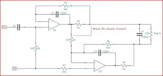

Looking at the description of the filter, it seems the main concepts are: flat response in the audio pass band, low source impedance to the ADC inputs, operation centered around a VQ of 2.7V, and attenuation of 20dB is adequate for anti-aliasing.
The 2700pF cap implies that the ADC is switched capacitor input, without any buffer. At 6MHz that's about 10 Ohms of filter output impedance. While it would be easy to use something like a lossy integrator to get the attenuation and centering around VQ, output impedance would be higher.
The amplifier arrangement, sometimes called "in the loop load compensation" is to cope with the capacitive loading on the OpAmps. Compensation like this has an adjustable Q so that the transition into roll-off can be much sharper than a simple RC. There is often some amount of tuning required to get the desired flatness. In this case though it looks like there is an error in the schematic that caused peaking with the part values.
Here's a schematic with reference designators:
You can see where I think the schematic goes wrong, with the connection of R4. But, before going into that, let's go over how the circuit should work.
With capacitive loading, an OpAmp will loose phase margin. A good OpAmp will typically have about 60 degrees of phase margin. But even a load of 100pF can cause phase margin to decline to 40 or 45 degrees, resulting in a peaky response. Addition of R2, C2, and R3 allows the amplifier to maintain phase margin with load. C2 rolls bandwidth back, increasing phase margin. R3 helps minimize phase margin loss with the addition of C4. R2 provides low frequency feedback to correct any passband error caused by R3.
Circuit response can be tuned by adjusting the value of C2. Making C2 larger will lower the Q of the filter. At low frequencies the loop of R2 dominates, but the C2 loop dominates at higher frequencies where C2 impedance is lower than R2+R3. Then the drop across R3 is uncompensated and the signal is attenuated by R3 C4 and eventual amplifier rolloff.

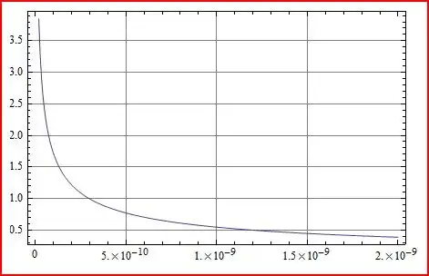

Consider just the non-inverting section with ideal amplifier. Transfer function, leaving out the zero of C1 R1 would be:
\$\frac{\text{Vo}}{\text{Vin}}\$ = \$\frac{\text{C2} s (\text{R2}+\text{R3})+1}{\text{C2} \text{C4} \text{R2} \text{R3} s^2+s (\text{C2} \text{R2}+\text{C2} \text{R3})+1}\$
The denominator looks suspiciously like the classical quadratic form containing Q and \$\omega _o\$, so derive those.
Q = \$\frac{\text{R2} \text{R3} \sqrt{\text{C4} \left(\frac{1}{\text{R2}}+\frac{1}{\text{R3}}\right)}}{\sqrt{\text{C2}} (\text{R2}+\text{R3})^{3/2}}\$
\$\omega _o\$ = \$\frac{\sqrt{\frac{1}{\text{R2}}+\frac{1}{\text{R3}}}}{\sqrt{\text{C2} \text{C4} (\text{R2}+\text{R3})}}\$
Since ideal amplifier was used to make things manageable, Q goes to infinity as C2 goes to zero. This won't be a problem since we only care about frequencies below amplifier bandwidth. With a real amplifier Q would fall off with amplifier gain. Pluging in values for R2, R3, and C4 we can plot Q as a function of C2.
Q decreases as value of C2 increases. If the amplifier is too peaky, just increase C2 too flatten out the response.
Now, looking at the curve, it looks like C2 of 470pF would have a Q of ~0.8. That would be pretty flat response. What happened?
In the datasheet the schematic show R4 connected to U1 output. This does 2 bad things. First, after going to some trouble to compensate out the low frequency effects of R3 and R6, connecting R4 to U1 out adds R3 drop back in. If you look at the output impedance of the filter you will see that is true. Second, it causes peaking to occur with C2 and C3 of 470pF (peak of Q is around 300pF, more or less than that Q decreases). If R4 is connected to the node with R2 R3 and C4, Q acts as expected. Also, filter output impedance will stay very low through audio passband, until rolloff and then follow C4 impedance.

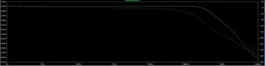

EDIT: After looking deeper, the exact values are used on their evaluation board for this part. So my recommendation is to first model it with the same part they are using, the 2068. This should hopefully show the correct operation.
EDIT2: I ran the ADC circuit on through QUCS, and they don't have proper spice models for real op amps. Linear Technology's LT spice is a very good free spice simulator. Running the circuit through there gives a nice flat response as predicted. (If you open this picture in a new tab, it blows up so you can see the details).
ADC circuit AC sweep results

  • Good find! It explains the goal a bit better, and provides examples for multiple situations, but it's not a detailed explanation of how the circuit works. (I guess they assume that if you're knowledgeable enough to appreciate their specs, you're knowledgeable enough to figure that out?) I discovered that if I remove the 470p caps around the opamps (open-circuit), the simulation does what I expect, but when they're there, I get the ~4dB peak at ~300kHz. Might they be real-world additions to help the specific amp that they tested with and not necessarily needed for mine? – AaronD Dec 30 '14 at 22:17
  • Also, since you found one for the ADC buffer, I looked for a complementary one for the DAC. There isn't. At least not an exact match. However, what I did find had the same topology as I found in the datasheet with about the same level of explanation as the ADC note. But this one did a much better job of choosing component values to preserve the CMRR and not misbehave like the one from the datasheet. (http://www.cirrus.com/en/pubs/appNote/AN048Rev2.pdf) – AaronD Dec 30 '14 at 22:23
  • I would suggest getting the model for the 2068 into your simulation first. The 470 pF capacitors are either for stability or they are for the low pass filter they mention. I had assumed the latter, but now I'm not so sure. – caveman Dec 31 '14 at 00:16
