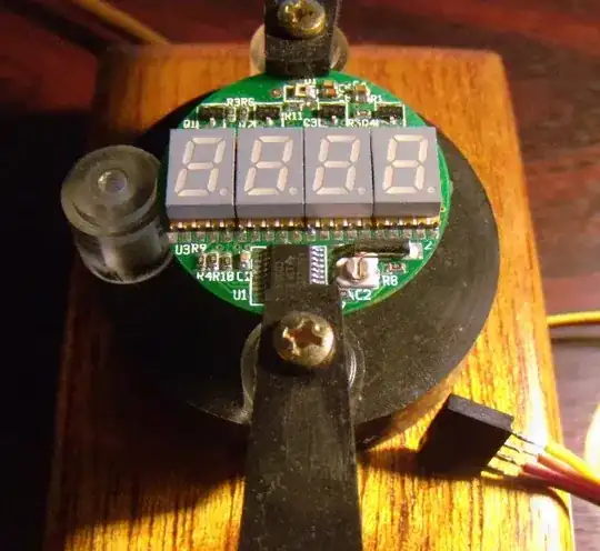

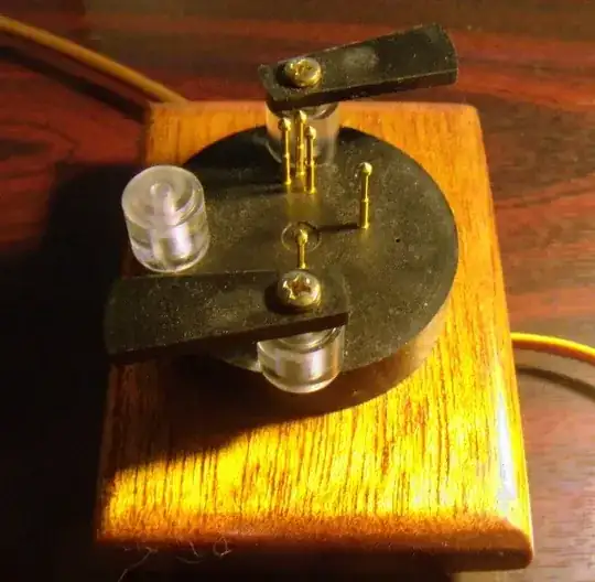

But here's an alternative approach, for boards where you don't have space to fit a header, or the standard header doesn't accomplish all your programming/setup/board test tasks.
Given a small form factor PCB as here (33mm diameter) enter image description here
you can lay it out with test points (labelled on the back) enter image description here
and create a test fixture for it (using Pogo Pins) enter image description here
This requires some machining ability and at least a pillar drill (because the pogo pins must be exactly vertical). However if you're willing to risk a prototype PCB you can clamp it to a sheet of material and "spot" through the testpoint holes to get the pogo pins in exactly the right place. (I get 10 PCBs for a ridiculously low price from Itead, so losing one is no big deal).
With a lathe and mill, making the pillars and clamps to locate the PCB in exactly the right place is a doddle, but it's not too difficult with simpler tools.
Then you simply fit each PCB, program and test it. The loose connector normally goes to header pins on a TI Launchpad, used for programming this MPU (TI MSP430) via the SBW interface, but the same principle would apply to JTAG or other interfaces. (The brown cable at the top is a co-ax cable carrying a calibration signal to a frequency counter). enter image description here

    This is a great answer and thanks for taking the time to provide such a useful detailed response! I didn't mark it as the answer because in my case, I have the space to fit in an ICSP header but it's something I'll keep in mind if I have to build anything tiny. – edcs Dec 26 '14 at 18:04
    That's a pretty jig (or is it a fixture?). Is there anything to key the PCB angle-wise or is it just lined up by eye? – Spehro Pefhany Dec 26 '14 at 19:59
  • I eyeball the pogo pins through the visible testpoint holes before I push down and swing the clamps in. Crude but it works. On a larger PCB I'd recommend a couple of location pins, e.g. in the PCB mounting holes. –  Dec 26 '14 at 20:46

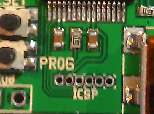

I always add space for an ICSP header, even if it's not populated. I have three ways of doing it at the moment depending on situation.

The third way is to provide a "staggered" or "offset" header footprint for ICSP. I use this mainly on development boards where the end user may want to do ICSP but doesn't want to ruin their board by soldering a header in permanently. This footprint allows a standard header to push-fit and make good solid contact without any solder:
