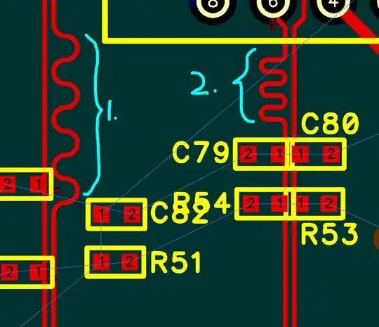

I am routing a PCB with an Ethernet connection and I am having a bit of trouble deciding on how best to route the TX and RX differential pairs. I have done the impedance calculations to figure out the track geometry needed for 100 ohm differential impedance and confirmed it with the board house. However, I have a bit of a length mismatch between the TX+/TX- and RX+/RX- pairs (about 5mm). Hence, I am employing the "squiggly line technique" to minimize the length mismatch of the traces in a pair.
My question is whether there is a rule of thumb or a precise calculation to figure out the squiggly line geometry? To illustrate what I mean, have a look at the attachment - I have routed one pair with "loose" squiggles (labelled 1. in the image) and another pair with "tight" squiggles (labelled 2, in the image). Which one is better and does it matter at all? My concern with the "tight squiggles" is degrading signal quality due to reflections as the squiggles are close to 90 degree angles which most app notes strongly advise against. The "loose squiggles" on the other hand take up more space and hence am I degrading my differential impedance?

Your bigger concern with tight squiggles is that part of your signal can couple right through them and end up coming out the other side sooner than you think. Best to use larger like your first drawing.
Also keep the squiggles close to either your transmitter, receiver or connector. Perhaps less than 1/4 wavelength of the highest frequency content of interest away from your transmitter. Best to lump discontinuities together.
