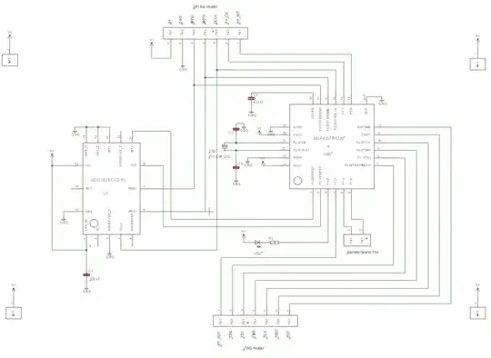

The first PCB I did a few years back I used functional groupings on the schematic, then when I switched over to do the PCB, the number of crossings and vias made it a complete mess. Since then I've made every single schematic symbol true pin order, then focused on making sure as few lines on the schematic cross, meaning minimizing the crossings on the PCB. This has produced very clean and efficient boards, however, I don't think my method will scale well when doing very large boards.
For those of you that use functional pin groupings, how the hell can you produce an efficient PCB without too many crossings or vias? For instance, PORTB on an ATmega could be spread out on all 4 sides of the IC. If you group them together as a functional block you may assign them to one device then have an absolute nightmare when you switch over to do the routing. This easily could've been avoided if you noticed: "Hey, PB0, PD7 and PD6 are all right next to each other, maybe that'd be the better choice."
So I'm not trying to convince anyone of anything, I just recognize that the more professional route is functional pin groupings, but I simply don't know how to translate that to an efficient PCB.
I've included one of my schematics as an example of how I do it. This board was 1 square centimeter and so every single via was major real estate.

  • You answered your own question. Since the parts don't change, if you are able to minimize crossings on your schematic, you can also do it on the PCB layout. – whatsisname Dec 22 '14 at 22:20
This is a great example of why the same engineer that designed the circuit should do the layout and routing. The schematic is for communicating the circuit, so pins should definitely be arranged functionally without regard to physical pin order. This is much better for most uses of the schematic.
However, layout and routing is not one of those uses. The solution is to see this as part of the layout and routing problem, not something to be pushed back on the schematic. Most of the time, pins of a port of a microcontroller for example, are near each other. But sometimes not. You have to look at the ratsnest when doing layout, and see if there might be ways to simplify that without impacting the circuit. Yes, you might end up going back and forth between the schematic and the layout, and moving nets around between pins.
Fortunately, this sounds like a bigger deal that it really is. Most of the time, arbitrary connections can be accomodated well enough. Sometimes you have a really tight board with few layers that is really cost-sensitive. In that case, you spend the extra engineering effort to swap things around to simplify the board. Again, that's the unusual case. Most products aren't high enough volume to justify this level of optimization during engineering.

  • I'll trust your experience then. I need to just make the switch to functional pin groupings and deal with the possible headache of having to rearrange and optimize things in the layout phase. Thanks a lot. – RabidAlpaca Dec 22 '14 at 17:44
