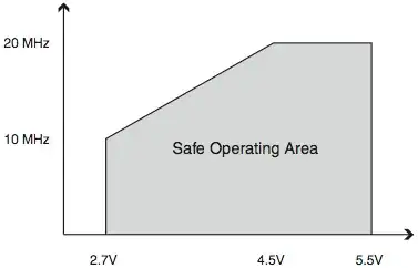

You can connect it directly, but note that the frequency you run it at is affected by voltage:
0- 4MHz@1.8 - 5.5V
0 - 10MHz@2.7 - 5.5V
0 - 20MHz@ 4.5 - 5.5V
kolosy
  • 2,288
  • 51
  • In practice though, you *can* clock the newer avr parts at ~16MHz down at 2.7 even though the datasheet says otherwise. I just wouldn't trust it for anything where timing is critical... – Luke Gary May 25 '16 at 19:15
