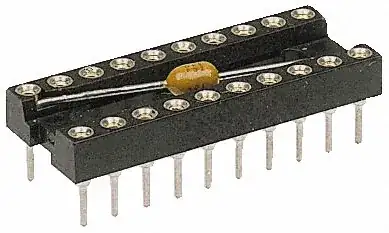

There used to be IC sockets with decoupling capacitors built in. Haven't seen them in years, tho

    can you provide examples or links to examples of these old IC sockets? – Jeff Atwood May 21 '11 at 06:29
    The question was about caps within ICs (die) or IC packages. This is an IC socket, not a package. These sockets may have been invented to save space on PCBs while SMT was not yet the norm, and they are limited to common logic packages where GND is on pin (#total_pins/2) and VCC is on pin (#total_pins) – zebonaut May 21 '11 at 08:29
    @Jeff - I added an image to lyndon's answer. The reason why you don't see those anymore is that they apply only to a specific pinning, like Vcc on pin 20, gnd on pin 10. Typically LSTTL and HCMOS building blocks. Placing power pins like that was a pretty daft idea to start with, and it's not done anymore. Modern ICs can have their power pins pretty much anywhere, but they're often placed more closely together. Also, this is DIL!, who uses that anymore? :-) – stevenvh May 21 '11 at 08:29
