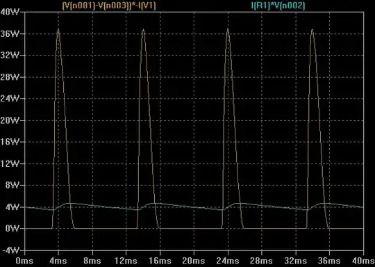

However, this is the power graph: enter image description here
The average values of the graphs give me 4.9W and 4.13W, which gives me an efficiency of 84%.
Which value is correct?

Averaging the instantaneous power is the correct approach here.
The product of the rms voltage and current gives the apparent power. The average power is, in general, less than the apparent power due to a less than unity power factor.
See this related question for a detailed answer on the power factor calculation.
