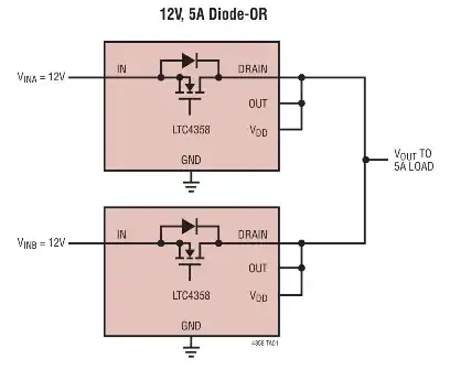

There are IC's which can provide this functionality.
One option would be to use a "Power Multiplexor". An example is the TPS2115. It takes the place of the diodes and switches, and is controlled by a 2V-compatible logic signal. Its internal resistance is 110 milli-Ohm (or less), which give a voltage drop of 0.6 mV (!) at 5mA of current. You can find them for around $0.85 in quantities of 1000+.
powermux
There are two possible problems with this chip: it only operates down to 2.8V (not 2.5), and it has a 55uA quiescent current. I don't know how important these are for your design.
Other options could be an "Ideal Diode", or an "Ideal Diode Controller". Linear has a good selection, see here for examples.
idealdiode
To see even more options, here is Digikey's selection of related Power Management IC's (PMIC's)to dig through.
Good luck!

  • I never really considered ideal diodes as a replacement... If I can find one that fits the bill (low enough voltage, current, and cost) then I am eternally in your debt! – MrPhooky Jan 26 '15 at 14:52
  • @elliotdawes Let me know if it works for you, and consider the debt repaid :) – bitsmack Jan 26 '15 at 17:32
  • Excellent! That's been a really great help and will save me a lot of hassle! The ideal diode / PMIC idea has given quite a few good leads that I have looked into and generally one of the cheapest options! Thanks. – MrPhooky Jan 29 '15 at 08:50

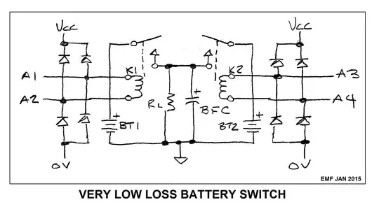

K1 and K2 are single coil Form A (SPSTNO) latching relays, and the diodes on their coils are for spike suppression. 1N4148s or similar will be fine.
RL is the load, the BFC is used to maintain the voltage on the load while the relays switch batteries, and the circuit works like this:
With both relays open, a short pulse is sent to A1 while A2 is at 0V, closing K1's contacts and connecting BT1 to the load.
Later, when it comes time to switch batteries, A1 and A4 are connected to 0V and a short pulse is sent to A2, opening K1's contacts. Then, after a fixed delay, (ensuring that BT1 and BT2 won't be shorted through the relays) a short pulse is sent to A3 which will close K2's contacts and connect BT2 to the load.
During the switching delay, the BFC will keep the voltage across the load from drooping out of spec and should negate the effects of contact bounce on the load.
In the configuration shown, it's possible that, inadvertently, both sets of relay contacts could be closed at once, connecting the batteries in parallel, which could be a Bad Thing. It's also possible, with a little extra hardware and/or some clever programming, to preclude such a possibility.
