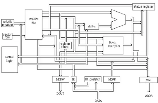

For example: the diagram below shows a top-level block for an ARM processor (source).
Once you have your top-level spec, you then need to design the architecture. You might model it and simulate it in Verilog or C++ or your favourite high-level language and arrive at something like this where you have added ALU, shifter etc.. to implement the required functions of the specifications: enter image description here
Then at the design level you will design individual blocks in RTL Verilog (for example).
Once this simulates OK. You can use the tools to implement the design. Typically this means Synthesis from RTL to Cell-Library, Placement of the Cells, Routing of the cells, parasitic extraction, timing analysis etc.
The tools do a lot of the heavy lifting at the implementation stage but they do not do the design.
