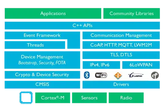

You're missing mbed OS: enter image description here
pros
  • directly supported (promoted) by the core designer - ARM Ltd.
cons
  • its first stable release is expected (planned) only in Nov'15 :-]
