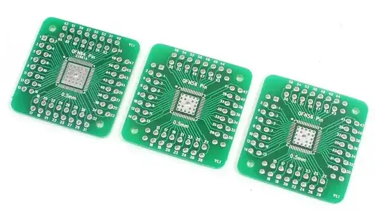

I would suggest to buy a QFN to DIP adapter, something like this.
Then, you can use air reflow or solder with an iron. I solder all 0.5mm pitch components, such as CPLDs or FPGAs with a good soldering iron using a small (thin) tip.

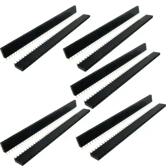

However, it might not fit well into your breadboard since there are two parallel rows on each side. What I usually do is solder DIP female pin headers
on this board and then use wires to connect it to the bread brad.

    This solution is easy in terms of soldering, but you need to pay attention at the comments to your question above such as @mattyoung about layout and RF interference that might potentially make the board not usable. Depending on you budget, I would suggest designing your own PCB board or find one that will accommodate your circuit. – Nazar Dec 11 '14 at 16:59
    How do these adapters help? The question was about how to solder the chip. Whether you solder to your own board or to this adapter, you still have the same problem. – Olin Lathrop Dec 11 '14 at 17:41
    @Naz That's not just what you understood, that was literally his question. "I just want to know what is the best way, that is relatively safe (so I won't destroy the chip), to get it on a bread board." – ACD Dec 11 '14 at 18:43
    But either way, he still has to solder the chip to a board. Whether that is a adapter board or his own board makes no difference to the difficulty or the procedure. The hard part here is soldering the chip onto a board, something that is out of reach if the only tool you have is a ordinary soldering iron. You make it sound a lot simpler than it is by glossing over the real problem. – Olin Lathrop Dec 11 '14 at 19:17
