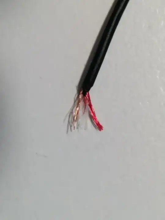

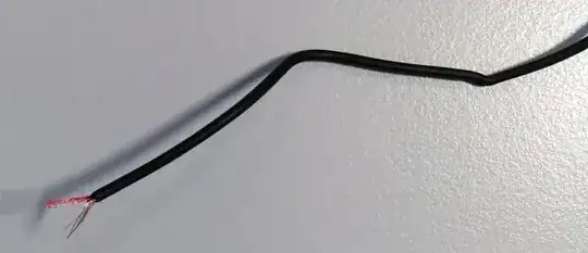

This is a picture of the cable. One part is varnished(maybe not the correct word in English). I don't have a caliper, but I think the tickness of the cable is about 1.5-2mm.
Could someone please tell me what kind of cable is this?
EDIT: adding two more pictures of the end of the cable:
The while bit that can be seems is more like fabric, not wire.
  • Could you get a better picture? Seems like a normal 2-wire cable, where the inner conductor is enameled. – anrieff Dec 08 '14 at 10:53
    I can take another picture, but what do you mean by better? – Ivaylo Strandjev Dec 08 '14 at 11:15
  • I think he is asking for a picture that zooms in on the stripped end of the cable. Even with the reduced size that I edited into your question the interesting part of the picture is less than 3% of the image. – Michael Karas Dec 08 '14 at 12:42
  • I'd bet that it's the same kind of cable, just with separate left and right channels. – clabacchio Dec 08 '14 at 12:42
  • Two more photos uploaded. @clabacchio I think it is. However this does not make it easier for me to find this type of cable online. – Ivaylo Strandjev Dec 08 '14 at 12:53
If this is the cable that runs between the two earpieces, all you need is two conductors.
The original cable uses enamelled wire of two different colors. The enamel coating with burn off when you tin the conductors. Simply twist all of the strands of one color together, then hold the twisted wires in a ball of molten solder on your soldering iron tip.
Be careful not to get one strand of the other color in the twisted bundle - this would result in a short circuit.
