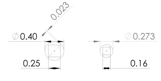

Did this up graphically for ref, and for 50-mil calcs. Using the .040" hole for the .025" yields a radial-clearance of ~.0023", see below.
-enter image description here
Note the dimensions are x10 here, makes for a clearer picture to illustrate.
If interested, this yields a 0.0273" hole for a 50-mil header, a 0.7mm drill seems best here.
