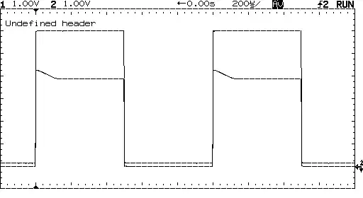

Here is a comparison between the generated square wave and the sync signal:
(Comparison between the generated square wave and the sync signal.)

I'm not familiar with TTL modules (I know they are a BJT technology used in the manufacture of logic gates, but that's it), a bit of searching revealed to me that TTL signals are very badly suited to transmission lines because of their varying output impedance on their "high" and "low" levels. In fact, the displayed sync wave (connecting the sync output directly to one of the channels of the scope, reading voltage over an open circuit basically) is an approx. 4V square wave with a 400mV overshoot (approximately 100us long), and with an approx. 200mV DC offset, which is consistent with my findings (TTL low levels are 0-0,4V, while TTL high levels are 2,2V-VCC). If I read the voltage differential on the coax with the 50 ohm terminator plugged in, the overshoot completely disappears (and of course voltage approximately halves). Why is this? Is this related to that variable output impedance?

  • I know this. I'm actually enquiring over the nature of the signal, and its characteristics. The assignment's question is: "why does the sync signal have faster rise times? Is it best to use this signal or the generated 1kHz square wave to evaluate propagation delays over the cable?". I have added two pictures showing the difference between the generated signal and the sync signal, and an excerpt from the manual. – Adriano Petrosillo Dec 06 '14 at 20:53

  • This is clear to me, probably I didn't make myself understood. I have added information on the sync signal and a capture from the scope, comparing the generated square wave to the sync signal (both sent directly into the oscilloscope over a coaxial cable) in the OP. – Adriano Petrosillo Dec 06 '14 at 20:29
The reason that the voltage of the sync signal halves when you terminate the cable is because the sync signal comes from a generator with a 50 ohm source impedance and the terminator is, ostensibly, 50 ohms as well.
Considering the transmission line between them lossless, that forms a 2:1 voltage divider, with the voltage across the load being 1/2 of the generator's open-circuit voltage.
If your sync signal has crispy edges, then it's a no-brainer; use it as the test signal and measure the delay of an edge from channel A to channel B.
With the 5 meters of coax between them and terminated at channel B, you should see something like a 20-25 nanosecond delay from channel A to channel B if your coax has a solid polyethylene dielectric.
