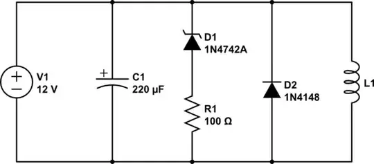

I'm currently using this circuit:
L1 is the magnet; I don't know its inductance, but it has a series resistance of 20 Ohms. D1 is the zener that protects against overvoltage; R1 is there because the only zener I had was exactly 12V and I wanted some safety margin to avoid a short in case the power supply went high for some reason other than L1. D2 is the flyback; it protects against voltages less than -1V, which hopefully aren't enough to ruin the cap (a schottky would be better, but I don't have one lying around).
I operate this by turning the power supply on and off. In the future I'll put a Darlington between C1 and V1. It SEEMS to work and not damage anything even when I force the plates apart, so that's good, hopefully I'm not doing anything nasty to the power supply. I still need to look at this with a scope to make sure.
I did have the idea of putting my own inductor in series with L1. This would act to limit current changes caused by L1's inductance changing. Not sure if I'll do that.

  • Three totally different answers so far. I'll need to think on this. Clearly, the zener is the most conservative option. – Ed Krohne Dec 06 '14 at 12:11
