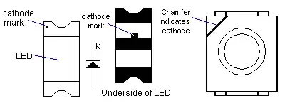

SMD LEDs normally have some kind of marking like the following image from here indicates:
The site states
The CATHODE lead is always the lead to be identified with ALL LEDs, including surface-mount LEDs.
There are definitely manufactures that do NOT follow this scheme like this one from CREE.
