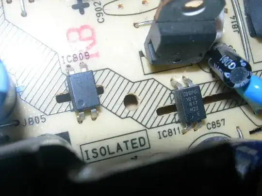

    In 2000 I was working as a trainee in a small computer repair store when there was a big flood in my city. After that catastrophe, people sent us a lot of dirty computers to try save them. The only solution was to wash all of them with water just like the picture. And almost all of the computers were saved. But the hard drivers didn't have the same luck. – Daniel Grillo Dec 03 '14 at 10:55

  • I use to fix TVs in the 80-90s. I had no reservation about pulling the chassis, taking to the sink and scrubbing it with soap and water. Letting it dry over night. – lakeweb Sep 24 '19 at 20:08
