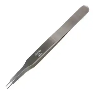

I find Erem 102ACA precision tweezers handy to place the wire,
Erem 102ACA tweezers

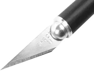

and a pointy knife like X-Acto to cut the wire after soldering.
X-Acto knife
