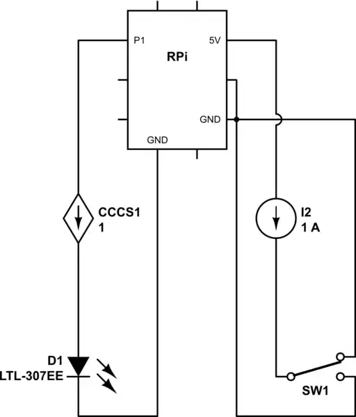

In parallel RC circuit, what is the behavior of current of capacitor C1? What is the time constant?

    Was this assigned as homework to you? If it was, we won't ruin your learning experience by doing it for you. If you expect help from us, please edit your question to tell us what you have tried and what specifically are you having trouble with. – Ricardo Nov 29 '14 at 18:48
  • It is not a hw question. Is the current of capacitor goes to infinity at the beginning? – tnt Nov 29 '14 at 19:11
  • infinity is a mathematical construct, doesn't exist in the real world. – vicatcu Nov 29 '14 at 19:29
    We don't just answer homework questions here, especially when no effort is shown on your part. – Olin Lathrop Nov 29 '14 at 19:39
  • -1 for horrible schematic! You should read this: [Rules and guidelines for drawing good schematics](http://electronics.stackexchange.com/questions/28251/rules-and-guidelines-for-drawing-good-schematics) – Kamil Nov 29 '14 at 20:36
In the circuit as drawn, I am assuming the voltage source and capacitor are ideal and the voltage source is producing an instantaneous step from 0 to 5 V. In this case, the model gives an infinite current (or a current impulse) into the capacitor at the time of the voltage step.
But that does not tell you much about what a real circuit would do. It just tells you you have created an unrealistic model.
A more realistic model would include series resistance in the voltage source and capacitor models, and a nonzero rise time for the voltage source's output step. Any one of these improvements in the model would result in a finite current into the capacitor.
