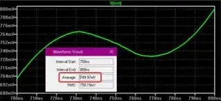

Quick partial solution (see average value for a specified time range)

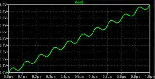

Suppose one has a chart like this:
And wishes to calculate an average value during [0.7us,0.8us].

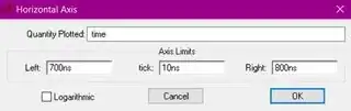

Step 1: Specify the time range.
Double click on the abscissa axis and specify the needed range. Alternatively use Zoom to Rectangle tool (magnifier button in the top bar).
Step 2: Calculate the average
Ctrl + left mouse click on a chart title (bold green title V(out) in the picture) to see the average value for the specified range.
