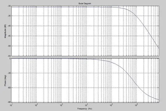

Here's what the mag/phase versus frequency looks like:
Null
