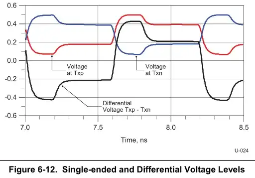

I've been reading a bunch, including the USB 3.0 spec, and I still don't get it. The transmit data lines are both capacitively coupled, so at the connector, SSTX are 0 V average?
Yet the voltage level diagram shows single-ended signals with a 0.3 VDC bias, is this before or after the coupling caps?:
Wouldn't this produce negative voltages on the receiver? Aren't the receiver ICs single supply? Is there a DC bias on either input or output? I read the part about how "8b/10b coding is DC-free", but I don't think that matters; it's like sending a 50% duty cycle square wave?

In the example waveforms you show, the voltages are at the pins of the chip, before the capacitive coupling. The transmitter has approximately 0.3V of DC bias because it runs on a positive voltage supply only. If the receiver was not connected, and you instead put a terminating resistor across the pair, you would find the average DC bias (after the capacitors) to be zero. With the receiver connected, you will find that the receiver is actually adding a DC bias to the signal, that DC bias being close to its transition threshold.

  • "the receiver is actually adding a DC bias to the signal" How? How much? – endolith Nov 19 '14 at 03:18
    The "how" is some combimation of leakage or a deliberately introduced bias, or diode clamps. The amount depends on the receiver chip, and probably isn't specified. I would expect anywhere between 0.3 and 1.0V. – Eric Smith Nov 19 '14 at 06:41
The input circuits are probably biased at either PECL logic levels or midrail. This is easily done when the input is capacitively coupled because the capacitor represents a massive impedance at low frequencies.
This requires that the data transmitted is dc balanced data i.e. contains no long-term dc values - this is achieved by either manchester encoding or scrambling. This works either on a balanced line or unbalanced line.
Some single supply inputs can of course work with negative voltages; consider the simple inverting op-amp input with unity gain on a single rail. If the inverting input is -3V the output will be forced to +3V with nothing anaomalous about either inputs at all. OK not all op-amps will work down to ground and this is a requirement for this type of circuit BUT it will still handle negative voltages on the input resistor without batting an eyelid.
