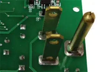

I'm having a difficult time figuring out how to actually implement the physical power jack. I've found one vendor with blade connectors intended to be soldered into a PCB. However, since they are the only one I can find, I expect there must be a more common way to do this.

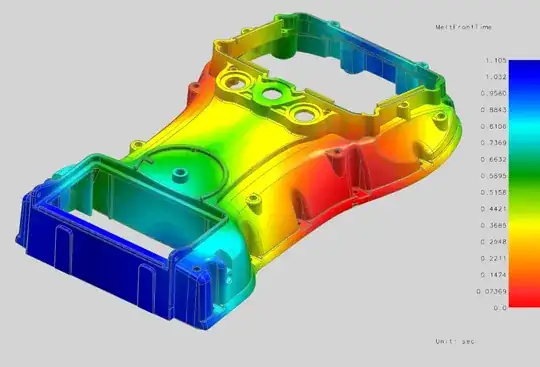

The mechanical considerations for a fresh design of such a case must include safety (no fire hazard, the pins must not come out and stay stuck in the outlet to electrocute someone), functionality (support the internal components and the stamped blades, allow for a plethora of world-wide plug styles) and must be easily manufactured (wall thicknesses- no parts too thick or too thin, preferably no slides or other side-action required in the mold) as well as being attractive (designed so sprue marks, blemishes from flow or jetting etc.) are minimized and/or hidden behind the label). It's also nice if it looks relatively cool and fits into packaging nicely. The resins and other materials used will be scrutinized by the safety agency folks. These days there is good software which can be used to predict mold filling and ensure the plastic part design and the injection mold design will work with few modifications required.
http://www.moldex3d.com/en/assets/2012/12/eDesignSYNC-for-NX-Melt-front-time.png
