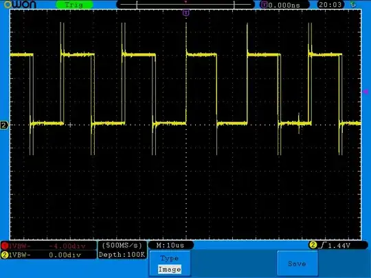

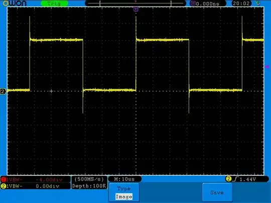

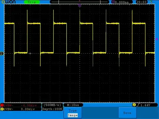

Update: Ok, so I ran the timer with reasonable settings. Below are results for:
500 counts 500
300 counts 300
200 counts (unstable as hell) 200
100 counts 100
50 counts (frequency is the same down to 0 counts) 50

You should test this with a more realistic "count to" number. There are clock ticks associated with entering and leaving interrupts, and you shouldn't expect good functionality with an interrupt every few ticks. Try it with 100 or 200, and let us know what happens. I still wouldn't expect the timer to be as slow as it is, even with your settings, but you should build a realistic test case.
With the updated figs, the period for the 100 count is about 38 microsecs, so the 100-count ticks are at about 19 microsec
(19e-6)/100 would be the clock count rate, = 19e-8.
1/19e-8 = 5.3 MHz
I'm not sure what speed your bus is programmed to go at
