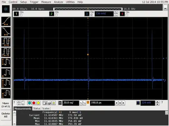

My goal: I am trying to phase lock a 74HC-based digital circuit from a clock reference at 10~15MHz pulse repetition rate. The pulse width is around 400 picosecond. The peak voltage is sometimes below 700mV, depending on the coax cable length.
I don't actually mind the shape of the clock; even a conversion to sine wave like waveform is accepted, as long as I can drive my 47HC based electronics from this weak pulsed trigger. Should I look for designs to pre-condition the clock reference? I generally aim at a low-cost solution, else it would be an over-kill for my digital board (~$50).
Clock reference at 10~15MHz pulse repetition rate

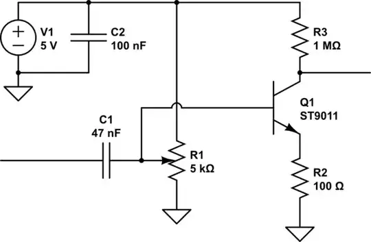

NPN class-C amplifier
I observe ringing at around 300mVpp but I cannot see the pulses:
simulate this circuit

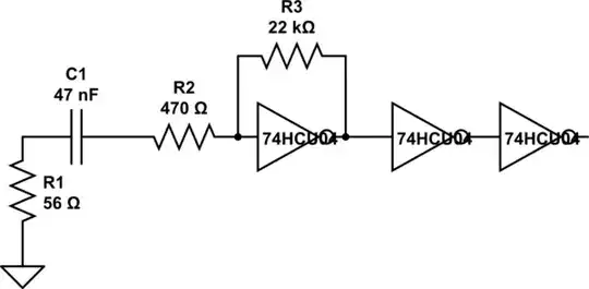

George Herold reminded me that my current-sourcing signal needs to be converted to a voltage before amplification. So I now connect the 50Ohm termination resistor in series with my amplifier gates.
As I only have HCU04 at hand, I tinkered with the capacitor-resistor combination to amplify the signal at multiple stage:
In stage 2 and 3, I have to AC-couple the signal so that it can be biased at VCC/2 at which amplification effect is the largest. Otherwise the baseline of the pulse signal will be drifting away to either VCC or GND where there will be no amplification. The 4th stage works simply like an inverter to give me a rising edge.

    Just thinking out loud- if the pulse width is ~400ps, any amplifier you're going to use is going to need to have frequency response out to the GHz range, wouldn't it? That might be why neither of those circuits worked quite right for you. – TheNoonMoose Nov 11 '14 at 17:55
  • So this is at the end of a piece of coax? Can you gain it up before then? Something like your transistor circuit. But 1 M ohm is going to be much too big. Maybe 1k or less. (make R2 smaller) There's the old pulse stretcher trick a diode into a cap with the a longer reset resistor to ground. But I'm not sure if a normal diode (1n4148) will be fast enough. (oh looking at a st9011 data sheet, that will not be fast enough.) – George Herold Nov 11 '14 at 18:00

  • @GeorgeHerold Yes the clock reference comes from a coax end. I cannot modify the circuit before the coax end as it will void the warranty. The above oscilloscope trace is already a back-to-back measurement -- I do expect a drop in peak voltage when I need to relay it to my digital board with a cable. – Antony Nov 12 '14 at 15:26

It's all about capacitances.
74HC-whatever is too slow for that. Input capacitance for each "block" of your circuit is 3.5pF. This is flattening your 0.4ns pulse.
ST9011 transistor is too slow too. Datasheet says: 370MHz bandwidth and 1.5pF collector-base capacitance. You probably also have some extra parasitic capacitances there.
400ps is quite short time, maybe not enough to charge your whole circuit capacitances. Wiring and PCB are very important when you deal with such short pulses or high frequencies.
You need ~2.5GHz transistor and correct wiring/PCB to eliminate parasitic capacitances.
2.5GHz because 1/0.0000000004s = 2500000000 Hz
High frequency transistors are not expensive, I just found random 6GHz transistor (BFR93A) and it costs less than 0.30$ where I live. You may look for something with higher gain or just try this.
