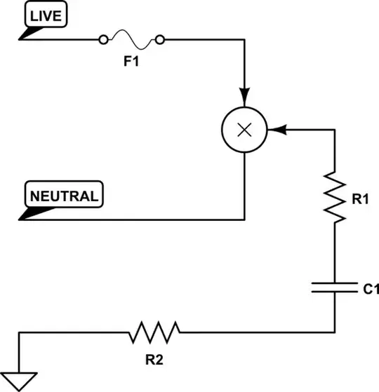

When a fault occurs in an un-earthed metal cased device the case becomes live. When you touch it you form a circuit. Now you'd think that current couldn't flow through solid wood, etc. Well, that would be the case for DC, but not for AC. You see, you form part of a capacitor. You're basically one plate of a capacitor, the ground being the other. The floor, your boots, etc, form the dielectric insulator between the two.
The capacitor would block any DC current, but it allows the AC to flow quite happily. The equivalent circuit would be:
The resistance of your body, and the resistance of the ground both limit the amount of current, but it only takes a tiny amount to kill you.
Now with the case grounded, and typically this involves a wire connecting the ground direct back to the ground point, which is also connected to neutral, and a fault occurs, the current will flow straight down the earth wire back to the neutral. This is a much much lower resistance connection than any human could provide, so considerably more current flows. This results in the fuse blowing isolating the circuit.
Also, if the fuse were not to blow for whatever reason (too high a rating?) the low resistance path would effectively short out the human reducing the current available to shock you to an absolutely minuscule amount.

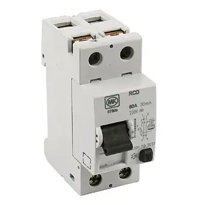

The whole scenario of your question misses one point - modern appliances (and I speak of Europe and probably several other parts of the world), do not rely on fuses to protect against electrocution.
RCDs (residual current devices) trip when there is a difference in current between the two AC wires of about 10mA to 30mA and these provide "safety" in the absence of an earth wire or earthed metal parts: -
http://www.performing-musician.com/pm/nov07/images/TechNotes_4.jpg
Fuses prevent fires and wires melting.
